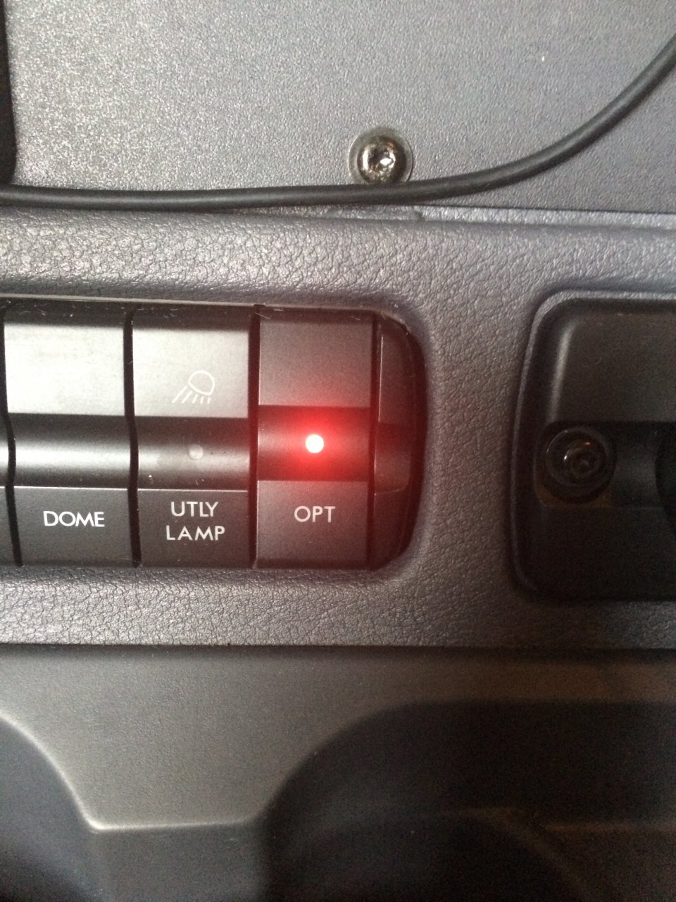

    Hi there. I just got into brand new 2016 Cascadia with no APU whatsoever :-O. There is one new button on the dash, that I do not know anything about, but I suspect may be related to Idle issue somehow. The button says OPT on it and works similarily to UTLY LAMP (red light comes on when turned on). If anybody knows what is it for and how to use correctly, I'm dying to know. Manual says nothing. Below is a pic of it: image.jpg

  4. mhyn
    mhyn Road Train Member
    4,255
    4,502
    Dec 29, 2008
    Northridge, CA
    opti -->optional. could be anything.
