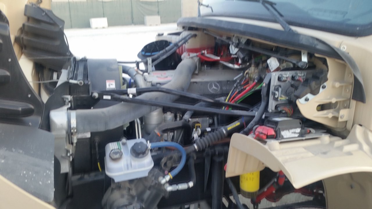

    Thanks Pablo for the reply back. I need to find out where Freightliner mounts the ECU on the M2s. I'm only familiar with the BHM and CCM. Here's a shot of the air fan clutch. 20160508_171036.jpg 20160508_171045.jpg

    Yes, this is OM906. And as I can see u have aftertreatemt modul too
    I'm surprised, becouse 906 PLD engine was replaced with OM936 (common rail).
    Ok, I can see 906 model is still in use.
    Fan clutch looks like horton air controlled clutch.
    Can u look for air solenoid? Does fan spin when air pressure in tanks is low?

    Fan does that free-spin thing. Just never kicks on. No air pressure on the line going to it, ever.
