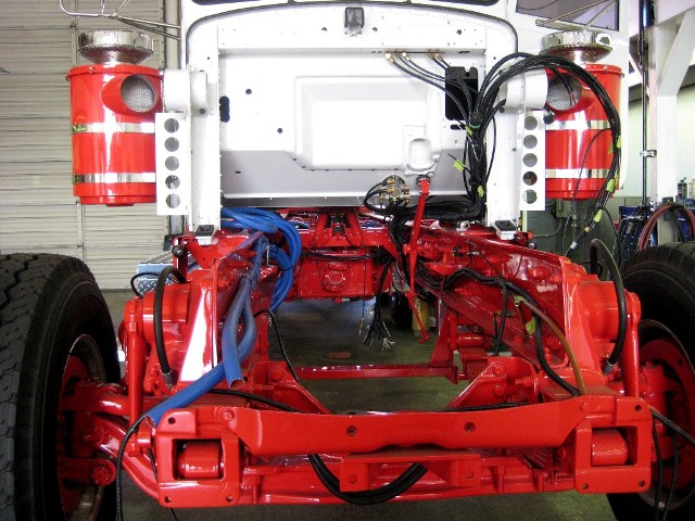

  8. kustom
    kustom Light Load Member
    59
    25
    Aug 11, 2010
    coos bay, oregon
    1981 peterbilt 359 with 389 20k lb front suspension and axle with dual steering boxes. I wish i had a better picture of this one, didn't think about it until it was done.
    1984 peterbilt 359 with 379 carhauler 5" drop front axle and custom 2 stage drop springs!
