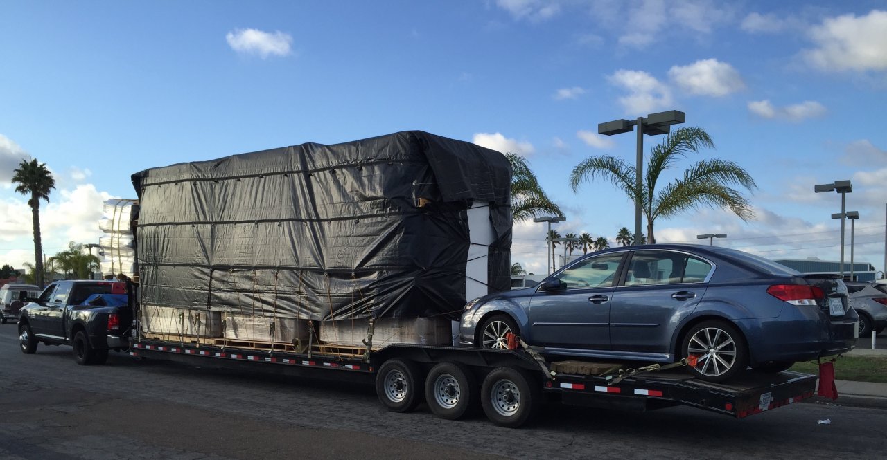

    The trailers I run here in my business are considered two car trailers but they have a 102" wide full wood deck. We like being able to haul LTL freight and vehicles. image.jpeg

    Flatbed, thanks for the reply. I actually want to do both cargo and vehicles, but that's absolutely impossible and there is no insurance for both......at least not on the car carrier forum, and those same forum members are on other sites as well, so it's hard to find the right info. In that 2nd photo with the tall cargo and 1 car, how did you get up that high to tarp it...folding ladder? Also it looks like you also have some cargo on the hitch, and I'm assuming you have a flat deck over there? So loading that.....was that cargo lighter than that 4500lb car? It has to be because that cargo looks big.

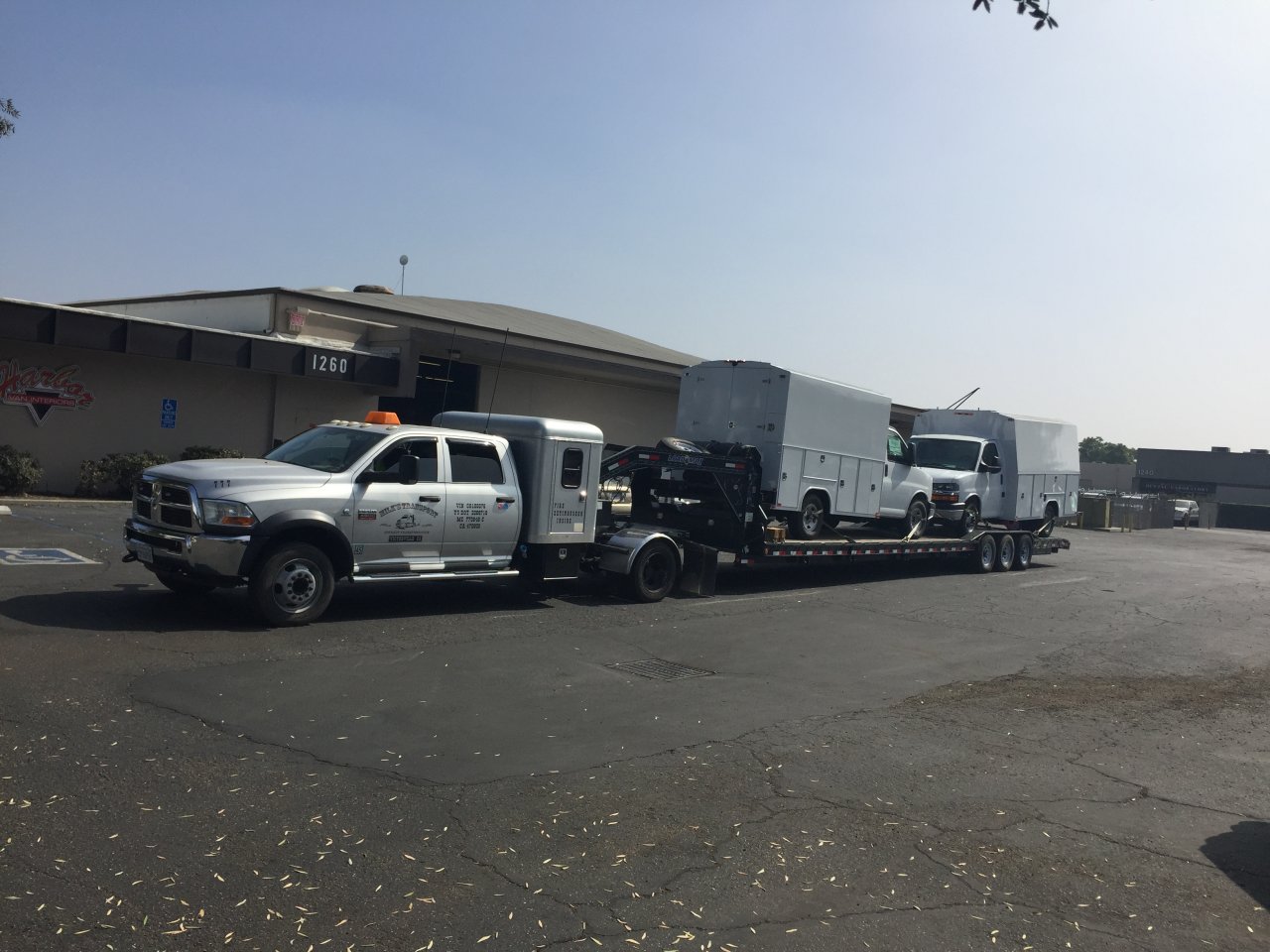

    Yes, you can get insurance for hauling vehicles and freight together. We work with several Independent Owner Operators based in Texas that do it everyday. 2 of the pictures I posted are actually TX based Owner Operators. I can give you phone numbers of insurance companies in your state if you want them.
