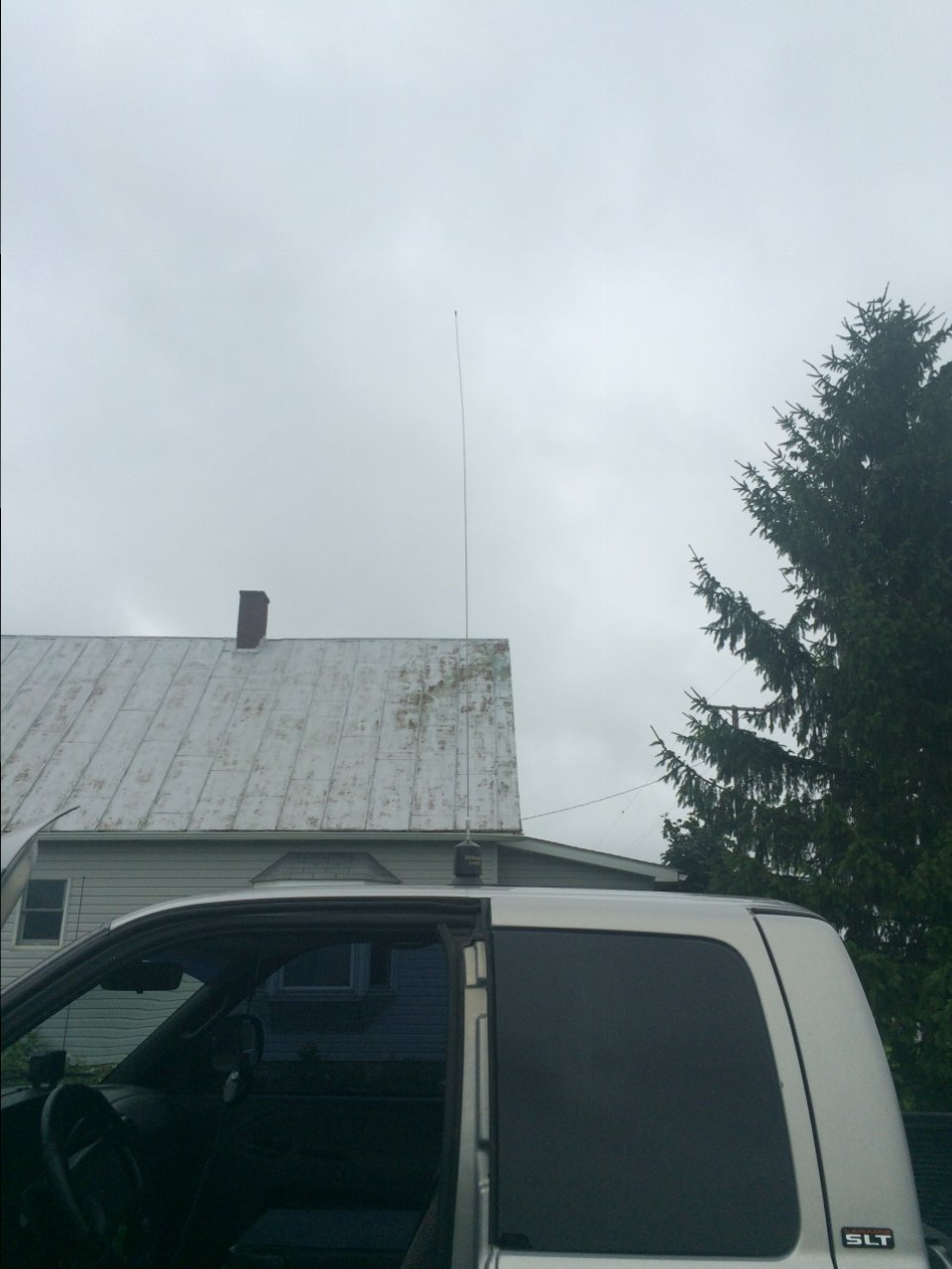

    Merely means you have a serious dip in radiation pattern off your back side. Take a pic post it maybe some change can be made in physical mounting to even out the pattern.

  9. Outlaw CB
