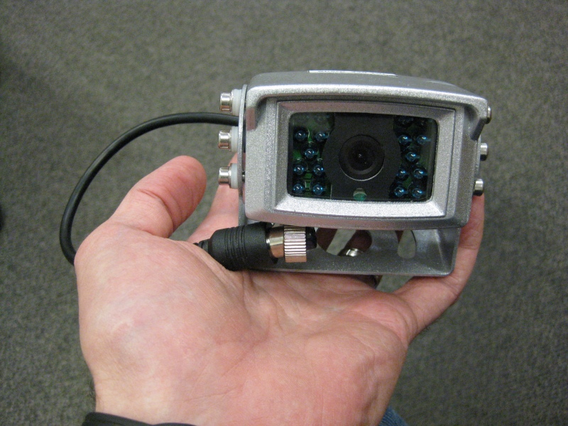

    Hey Dieselboss, have a question. What is the physical size of your outside cameras for your system? I looked all over your page and the details but did not see actual measurements. Also, can you spec in a Solid State Drive, like a 256gb. I know it would be less susceptible to shock/jarring/movement and so forth.

    Web page info needs to be updated. The new DVR can go up to 2 Tb hard drive size and also use SSD drives. SSD's are much more expensive than non, but we've got that now worked that out in the new model. Sizes for SSD's are typically 120 gb, 240gb, 480gb. But by the time you get to 480gb SSD size, remember that the hard drive costs nearly as much as the entire rest of the system.
    Physical size of the outside camera body itself is 2" x 3". It comes in 420 Tv Lines and 540 Tv lines flavors. Sharp CCD lens. 18 I/R beams. See picture.
    The_Judge Thanks this.

    @Dieselboss; thanks for the info. Will be thinking about your system and yes, A SSD might be more expensive but oh so worth it. You camera is a very nice size by the way and 18 I/R should illuminate for a good distance. Again, thanks!
