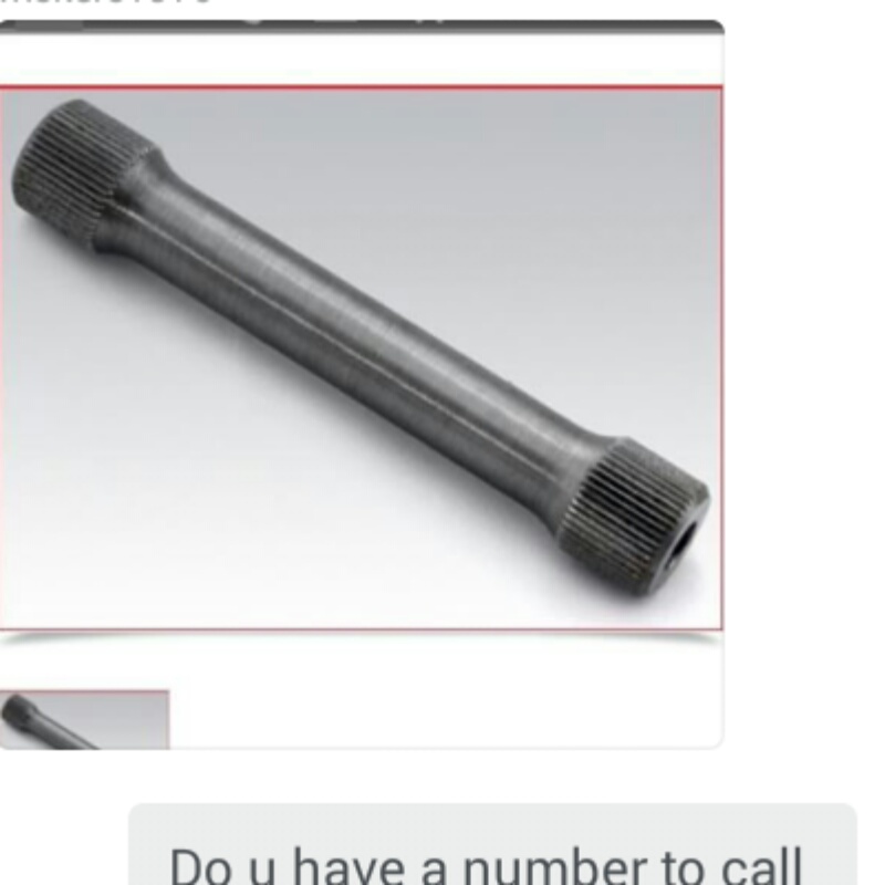

    Is this located behind the rear of the blower were the pulley drive for the altenator is? I was told that pulley needs to come off and its behind it?

    Yes that's the blower drive shaft. It won't run without it.
    There is no such thing as the governor being full and primed.
    It's a mechanical device only with a little oil for lubrication and has 0 to do with the "prime". There is no reason to take the cover off.
    There are 2 things a diesel needs to run. Fuel and air. If it won't run it isn't getting one or the other.
    Look/check for 'smoke' when cranking WITHOUT ether.
    White (or light gray) means too little fuel, or low compression.
    Black means too much fuel, or turbo not spinning (which comes back to too much fuel for correct air to fuel ratio). Or, if you have the blower drive shaft out:p
    It has an "emergency" shut off cable, which, as I said in an earlier post, is probably the "chrome T handle" in the cab. The emergency shutoff shuts off the air to the blower. If it's closed there will be black smoke (too much fuel for correct air to fuel ratio). It has to be pushed in, all the way. That's why I said (in another post) to check on the side of the blower at the top to ensure it's open. It has a lever with a notched 'cam'. Make sure the notch is in place with the lever holding it open. BUT, if it is/was closed you would be seeing black smoke WITHOUT ether.
    It sounds like you're just not getting enough fuel to the injectors. It takes a LOT to get the 'system' primed and no, an electric pump won't do the job. I posted a link to a hand held priming pump which is what you need. I thought 'pressurizing' the fuel tank might work but obviously it didn't. So, a mechanical priming pump is in your future, sooner rather than later.
    A "typical" fuel system consists of:
    (1)Tank, (2) line to "primary" filter (2a) (with a check valve at filter), (3) line to pump, (4) line to secondary fuel filter,(5) line(s) to head(s), (6) line(s) out of head with a restricted fitting at head exit.
    (The fuel pump is 2 gears meaning it is positive displacement with output proportional to the speed it's turning, but just as important is the volume.)
    I doubt it's "worn out". That's pretty unusual. Not impossible, but not probable.
    It probably siphoned itself dry (through the injectors) which is not unheard of. That means the injectors have to be primed, by hand.
    That means taking a valve cover off and 'cracking' some of the fuel lines on some of the injectors while 'priming' the system AND after it starts to purge ALL the air.
    Injector priming can be accomplished using just the battery cranking the engine over and purging the air one injector at a time until ALL air is purged.
    DO NOT USE ETHER. That crap is dangerous. It can accumulate in the crankcase and airbox and it WILL explode. Trust me, you don't want to be standing beside it when that happens.
