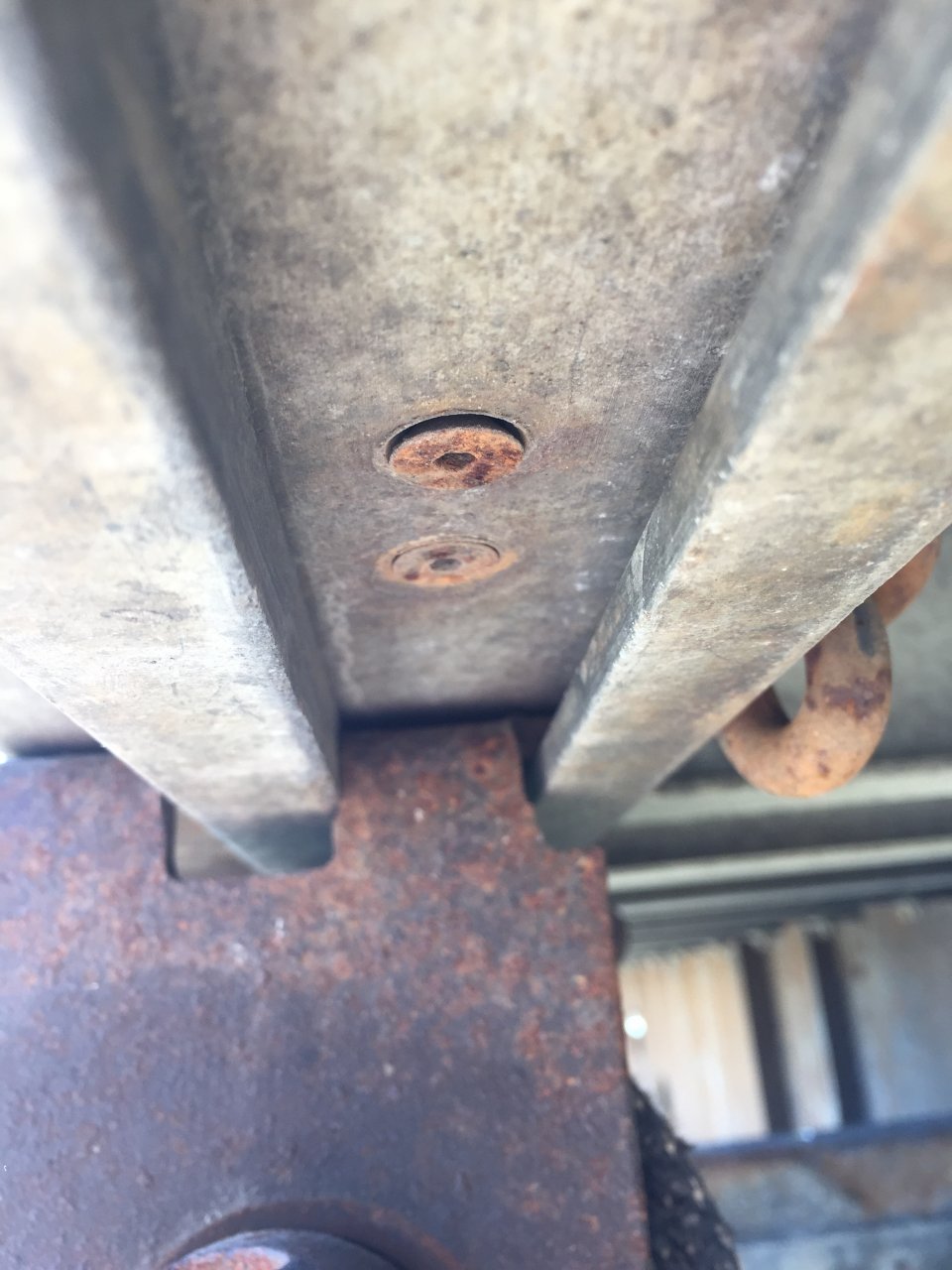

    We have an old transcraft with the aluminum double-L track that came loose over time. It was basically spot welded on at the factory. We rewelded it to the cross members and added self tapping floor bolts to the track at each cross member

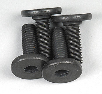

    Are those bolts countersunk?
  7. Riprap
    Riprap Light Load Member
    286
    1,979
    May 31, 2014
    Saginaw, MI
    Not that I remember, the bolts looked somewhat like this- except the first 1/2" of the threads were tapered and had tapping threads on them image.jpeg

    The double L track on my reitnouer is bolted up to the cross members with normal bolts. The winches just clear. Sometimes when the track rails get some grit build up they need a tap with the winch bar get motivated.
