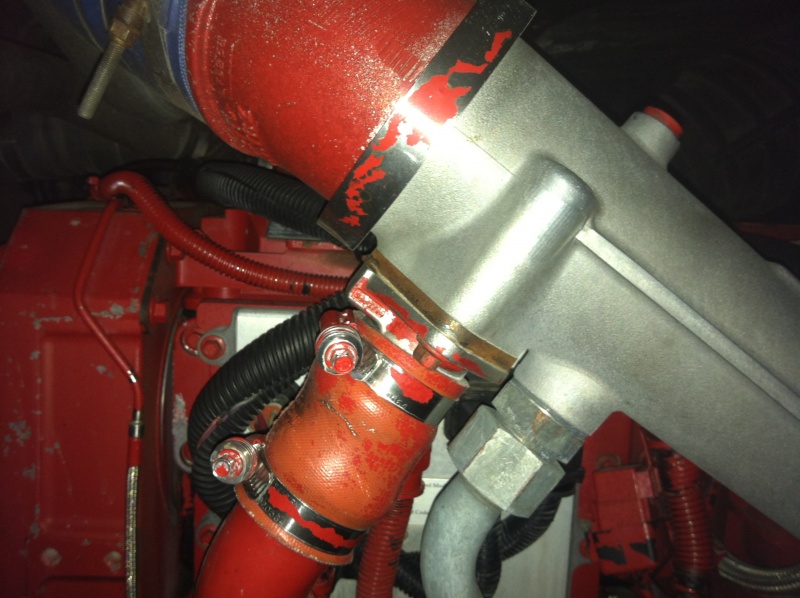

    I got a plate, pre-cut for the size of the port at the intake. PDI will sell you the plate. It is 1/4" steel. I just undid the EGR tube. The OEM adapter feeds a tube into the intake. I had to chop that off. Then I put the plate between that adapter and the intake. The original O ring seals up the plate to the intake. I used high temp gasket sealer to seal up the adapter to the plate.

    Pic of Pdi's blocking plate w/ Oring.
    I havent got the guts to install mine just yet.
