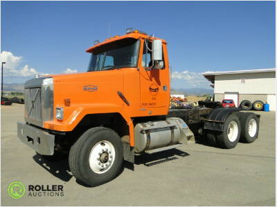

    I was thinking more of this Autocar model. They were very well built. Frames were all huckbolted together and the cabs were very wide. The deep cab option added another 2 or 3 inches of depth to the cab vs. the one in the pic. The VHD is what replaced this model in the early 2000's. I'm not a fan of Peterbilts off road because they like to hang their fuel tanks by the straps, rather than having a nice heavy saddle to support the tank underneath.
    Mr.X Thanks this.

    I remember seeing at least one those trucks at stimson lumber Priest river, Id, they are pretty rugged built! Didnt realize Peterbilt started hangin there fuel tanks by the straps, dont see many new Petes in the woods, and honestly don’t care enough for the new ones to take a real close look at the design. Probably any off road truck will do, if he wants a cheap one, then that’s fine, if he buys a nice one then there will likely be a little better resale value down the road. I hauled a lot of grain with highway trucks, most generally don’t have to worry about ground clearance to much, if a combine can do it most any truck can do it.
