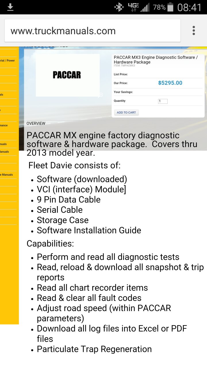

    Good question. I'm trying to find out also, most of the links I get bring me to this kind of help.. Screenshot_2015-06-17-08-41-07.jpg
