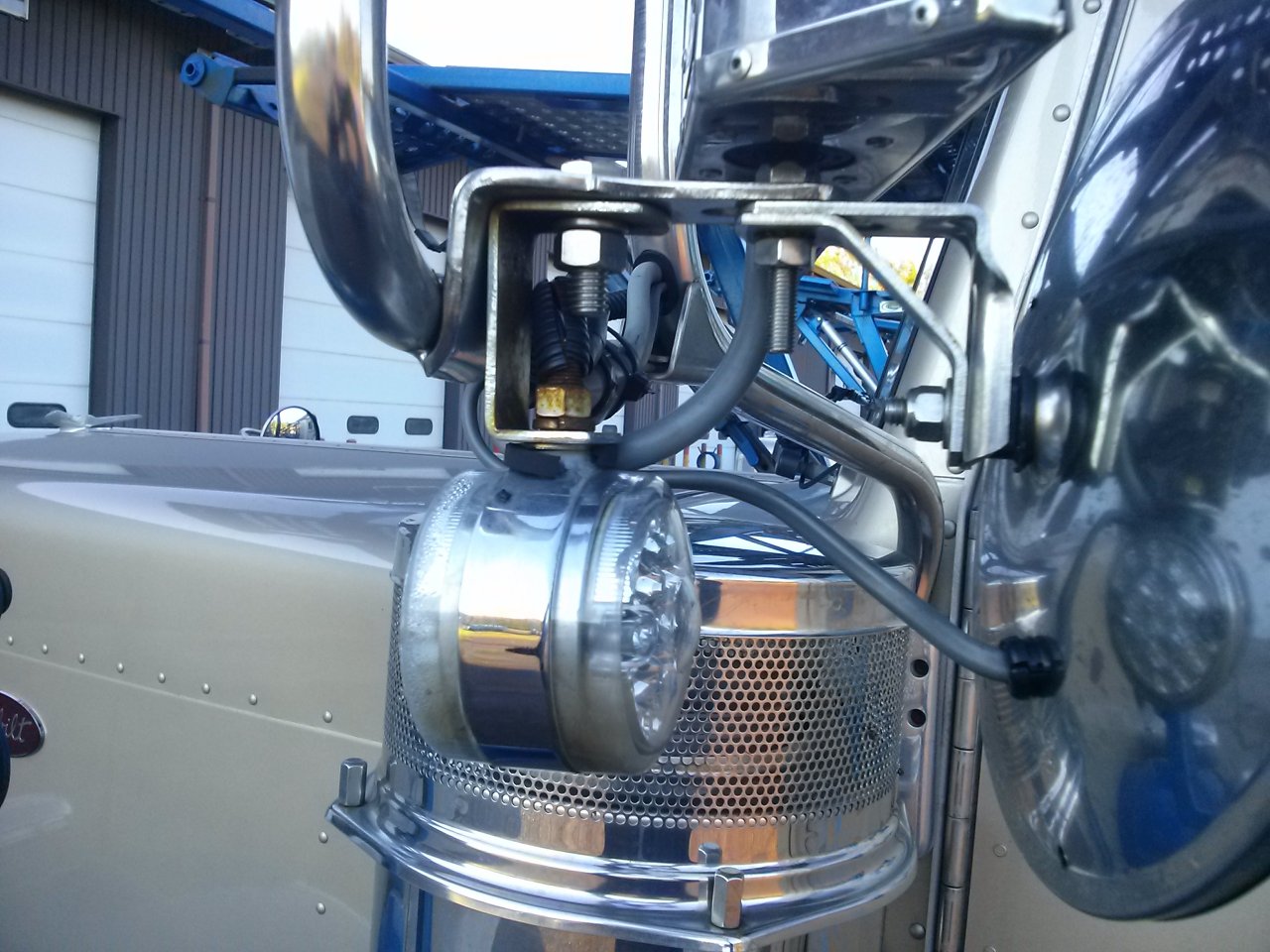

    Thank you, any pics?

    Here's a pic from one of our 388's, which should have the same mirror brackets as you. Pretty simple bracket, this one is the factory stainless bracket. All of the ones with the 4" lights ended up breaking and we made new ones out of a little thicker steel. This truck has a smaller lighter lights and the OEM bracket has been lasting.

    Awesome! Do you have a pic looking from the back to front. I keep thinking the convex will be in the way. Also what brand/model lights are they? They are a much cleaner look like you said.

    I just went on vacation, so I wont be back to get any more pics for 2 weeks. They do mount slightly behind the spot mirror, which is a good thing. Other traffic can see it, but the mirror blocks them from flashing in your face. They are quit bright and driving at night, you don't want to be blinded by your own signals.
