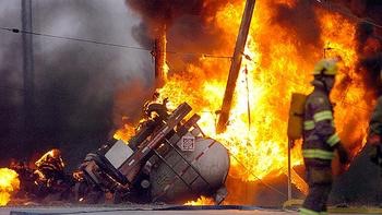

    I see Dinomite is back. (thanks for the chuckle), although, there's nothing funny about fuel hauling. Like others say, get a routine, and keep an eye on what's going on around you. Fuel tank drivers are the cream of the crop, they have to be. I never had the grapes to haul fuel (hauled 1 load of gasoline in my life, that was enough), it just wasn't for me. However, when you consider how much fuel this country goes through 1.38 billion gal. of gas in 2014 alone, that's 374 MILLION gal./day) and it all had to get to the gas station somehow ( no, there isn't a pipe of some sort leading to the station, like some people believe, honest), statistically speaking, incidents, like our friend Dinomite illustrates, are very rare. It's just when it does happen, it's big. Take your time, is the best advice I can give. You'll be fine.
