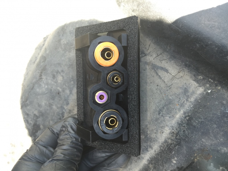

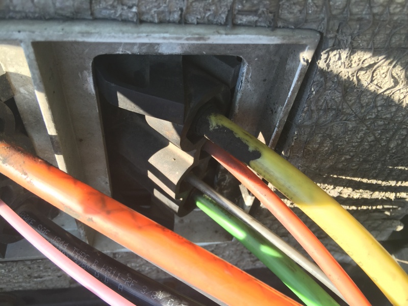

    How do I remove the air lines on this manifold? My air line is leaking here. 2000 kw T2000

    image.jpg image.jpg Please reference the pics.

    drain all air pressure and then push the ring around line in then pull on line as your pushing on the ring. should pop right out. may need a small screw driver or needle nose pliers to use to push down ring.

    Worked like a charm! Thanks buddy!
