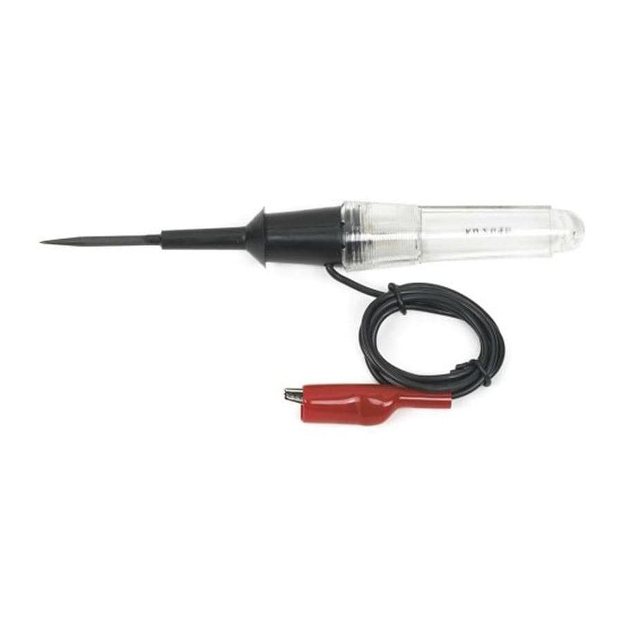

    First step you need this tester. Most truck stops have it.
    Next, Truck ignition is ON, all lights OFF
    Check the circuit from ABS unit to ABS light. Bulb is good?, bulb socket is good?
    Pull the pig tail out of truck receptacle check 12 volt is present on central pin. The pin is bigger then any other.
    If no 12 volt the problem is in truck
    If power is here check the trailer end of pig tail. If no 12 volt the problem is in pig tail or connection.
    If 12 volt is on trailer side of pig tail check the electrical cable under trailer for any damage. Look for insulation bulging the sign copper inside is rotten. Dont give up if you fixed one but still no blink. On my cable was three damages. Get under trailer tandems area look for the small box ABS unit. Check with manufacturer website for pin out and check power directly on ABS unit.
