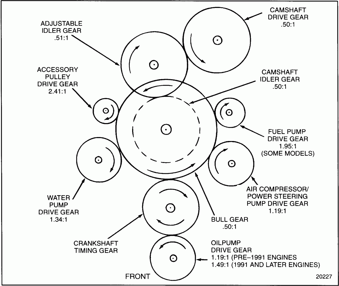

    Just remember how many gears and bearings are in the front cover. No way to check all of them without removing it.

    Not off hand. It could be p/s, air comp, water pump, access drive hub, bull gear, adjustable tensioner gear, idle gear.
    Remove each one and inspect it. Plus look straight down on housing for metal.
    I would say a oil sample would help. But we are to late for that party.
    Remove acc drive, check back lash with dial indicator, then pry it in and out looking for movement
