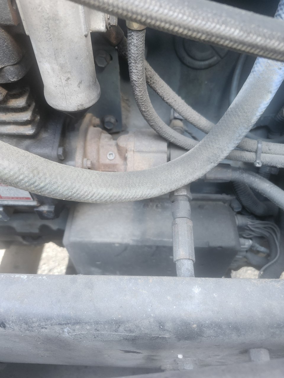

    Series 60 just have a 2 vein mechanical pump. It's a very simple system, unlike the DD15. 20250325_170003.jpg

    That looks like an oldie but goodie. DDEC II.

    You got it! When I put it in, there was a DDEC3 available for about $1,500 more. But it would have cost a lot more to convert the truck to work with a 3, so I went with the 450 hp 2. They couldn't get it to run in my truck, so they switched ecm to my 500 hp tune. I love it!
