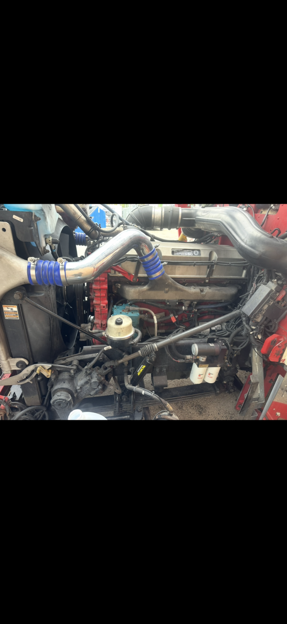

    I gotta say. I miss my old truck because it was absolutely sorted out and looked really nice. BUT this 12.7l seems like a great engine. It is the first one I have had. I was just up in the rockies last week and this thing performed amazing. It does have 4.10s which is helpful in the mountains. But this 12.7 pulled better, stayed cooler and the Jake's performed better than my N14. The only difference is the engine and the rear ends are 4.10 now vs 3.73. Fuel mileage is around 7.5 versus 6.5. Parts are cheaper. It stays cooler on every load than the N14. I often had problems keeping it cool. I gotta say I am a fan of the Detroit. I had an ISX, N14 and now this 12.7l. ISX had insane power because I had it tuned. But other than that this 12.7l is better than both in my opinion. Time will tell obviously but I have really liked it so far.

    IMG_7126.png I really liked mine and may buy another one.
    I had the Pittsburgh Power Box on mine and it pulled awesome with it. The extra HP prematurely ages it but I got 815,000 before I inframed it for oil consumption. In my opinion if it had made it to a million without the extra power I still would want the HP.
