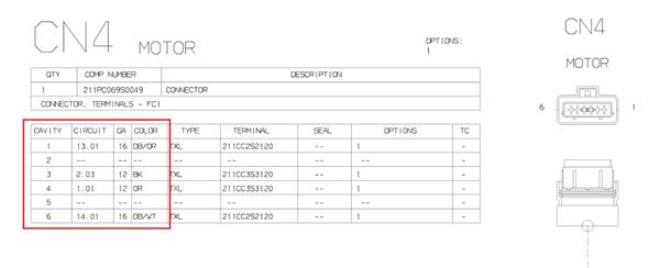

    A very nice lady at Mahle tech support sent me this info to get started. She did not have the signal voltage range, but now I know the pin out.
