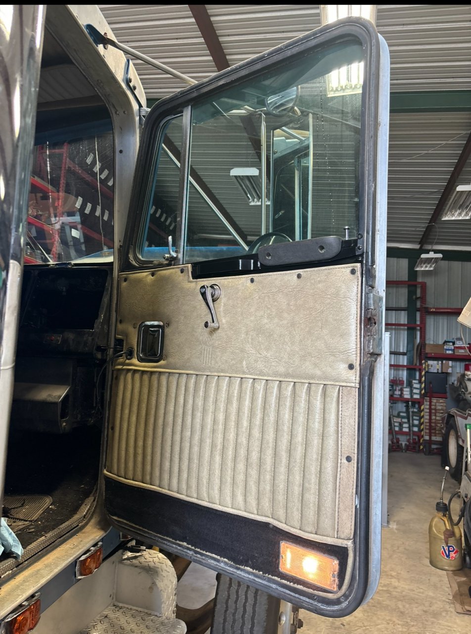

    I lowered the ones down on the ‘81 by welding on extensions and drilling holes in them to bolt to original place. Lowered original bottom step down 3-1/2”
  4. SmallPackage
    5,773
    18,530
    Dec 20, 2019
    Marion Texas
    Unfortunately. This is the only pic I have of the steel handle after I reassembled everything.
    Oxbow, D.Tibbitt, Feedman and 3 others Thank this.

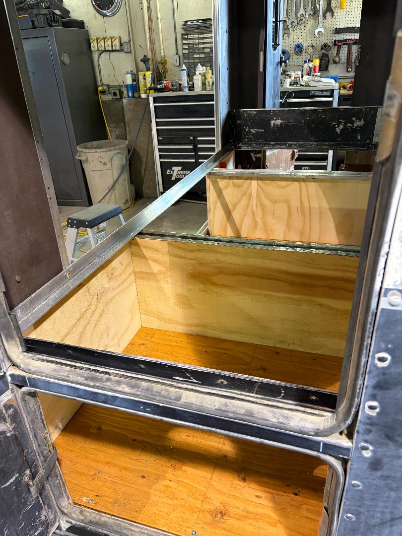

    Montana
    Cutting the big hole in the sleeper.
    Oxbow, IH Truck Guy, Feedman and 6 others Thank this.

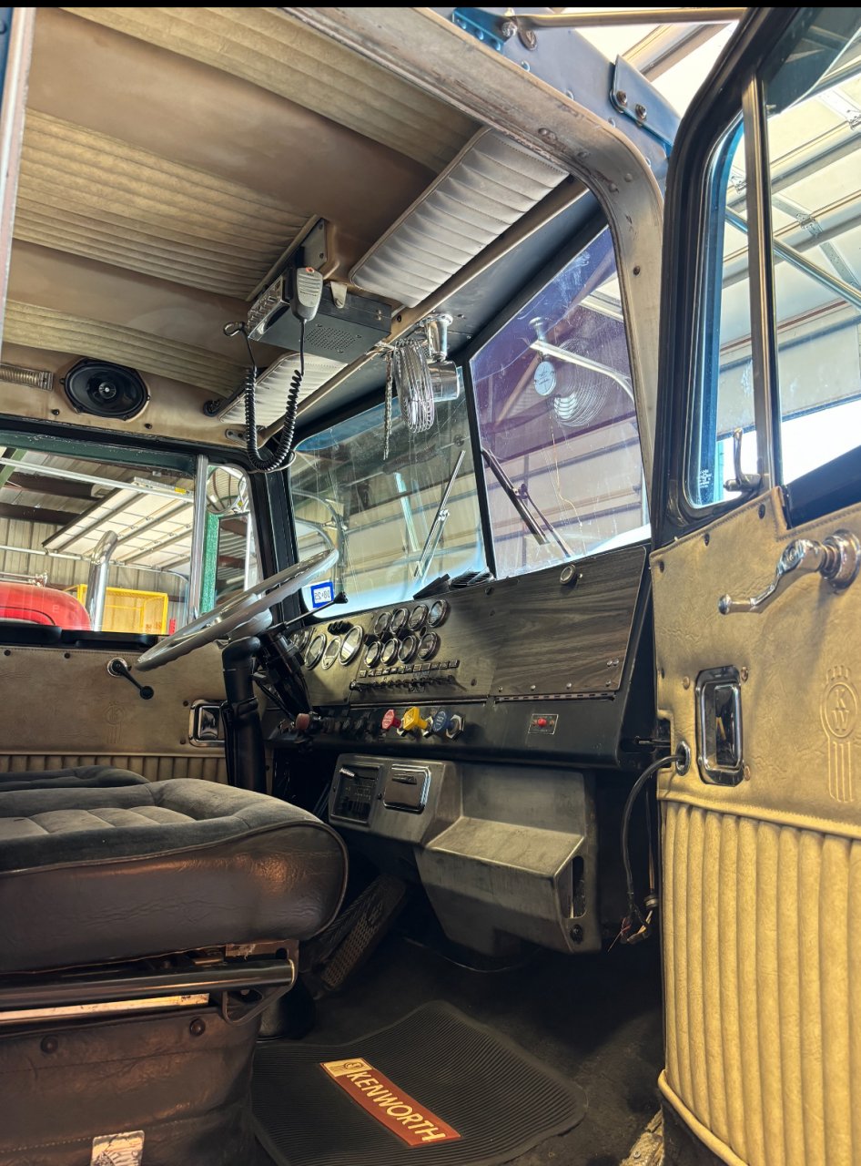

    Maybe u can educate me. Im to young to have seen 3 brake valves on the dash, and always wondered what the blue one was for? I see it alot in the older trucks maybe up until the mid 80s or so
  8. SmallPackage
    5,773
    18,530
    Dec 20, 2019
    Marion Texas
    It was called a “bus” valve. It was mandated for the new “121” brake rule in the mid 70’s. It is just an extra valve usually plumbed to an isolated tank that is tractor only to allow just enough air to release the cans so the truck can move to safety after a total air loss failure. They were originally mandated on air braked school and passenger busses in california as far back as the 50’s.
    The extra tanks that Pete mounts under the cab door were originally installed for that valve only. Now they are used for other things. That system was a pita and no one understood it so it went away by 83-84 time frame.
    Oxbow, 34kw, Feedman and 5 others Thank this.

  10. AModelCat
    29,658
    164,291
    Far as I can remember mine just had the standard 3 tanks.
  11. 34kw
    34kw Light Load Member
    87
    270
    Jul 28, 2010
    Montana
    Mine had the tank under the passenger seat. I took it out and put a different tank under the drivers step. I plumbed it in the same as it was. I guess I got it right because the blue button valve leaked before and it still does!
    Oxbow, Sons Hero, Feedman and 2 others Thank this.
