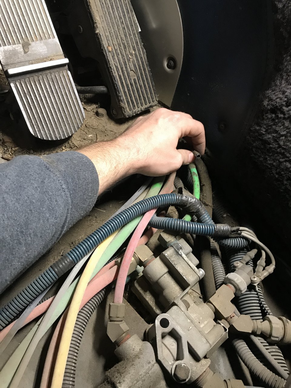

    1991 Intl 9670 COE
    Air leak was discovered when holding tractor with foot brake down hill at a stoplight using more than usual brake pedal force.
    When pushing brake pedal down, air leaks from the small hose (photo attached) in my hand under the floor pan. The harder the pedal is pushed, the more it leaks.
    I checked to see if this hose was broken loose from any fittings in the floor, and could not find anything it would attach to.
    -All brakes work normal.
    -Leak is not influenced by the position of the red tractor brake valve.
    -Leak is not influenced by the position of the yellow trailer brake valve.
    -Leak is not influenced by the position of the trailer hand valve.
    I am mechanically skilled, 15 years on the road, and I have only owned this old truck for a short time and still learning.
    Is it possible the hose was plugged or capped from the factory many years ago and blew said plug out?
    Is it possible this hose is supposed to flow air? (...I highly doubt it...)
    All pros please advise, thanks and God Bless. IMG_7998.JPG IMG_8329.JPG IMG_8330.JPG

    If you cannot find anywhere that hose goes to, I would plug it and sure that everything works correctly on your tractor and your trailer.
    If you do not have one, it is possible that was a capped line from the factory that was for the option of a brake application gauge.
    boneytrucker Thanks this.

    Hey that's something I did not consider. I do not have that gauge on my panel and it would make since to have that line on standby in-case one was installed. I did find a cylindrical piece of metal in the floor pan when I was cleaning up the mess shown in the pictures. I have a feeling that's probably it. Thanks for the reply Dino!
    Dino soar Thanks this.

    A few thousand miles after replacing the blown out plug with a good size screw, I can confirm that this line was indeed the culprit and no other issues have sprang up related to it. Thanks again for the help Dino.
    Boneytrucker
