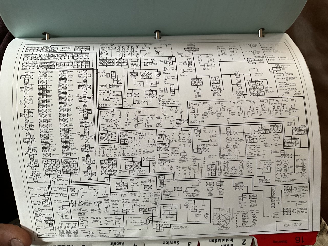

    Hello, I bought a service manual but the schematics are horrible. They just group every wire in blocks instead of actual lines for wires. I absolutely stumped on why when i turn on the headlights my low air buzzer fuse blows. Could this be the warning lamp module? But I can’t see why the headlights would interfere with this circuit. I did pull out the whole fuse panel and check for chaffed wires or corrosion, and everything looked good inside. Thank you.

    Check and clean your grounds ..
