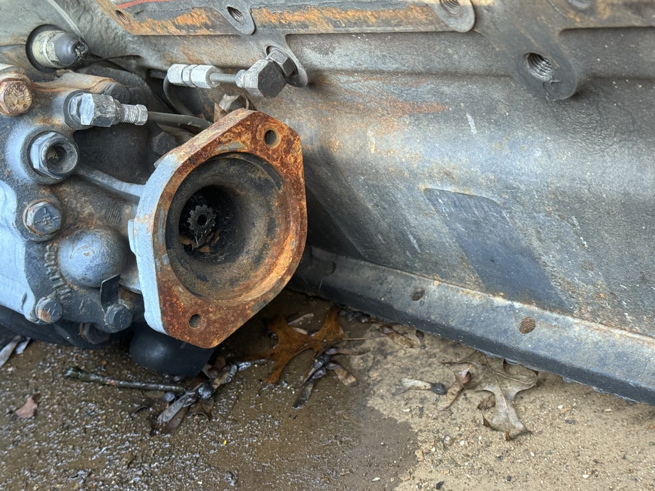

    Check the oil rail down the left side of the block too, I can’t remember where the sending unit is, but, there are multiple ports along the rail. Be just below the fuel pump front to back. I have a fitting in one of the ports to pressurize the oil system after having any of the bottom end loose….

    Just looked at an old N14 I have here, there is 6 ports along that rail. Easy to identify since the line from the oil pump goes into the front one…. IMG_5959.jpeg
