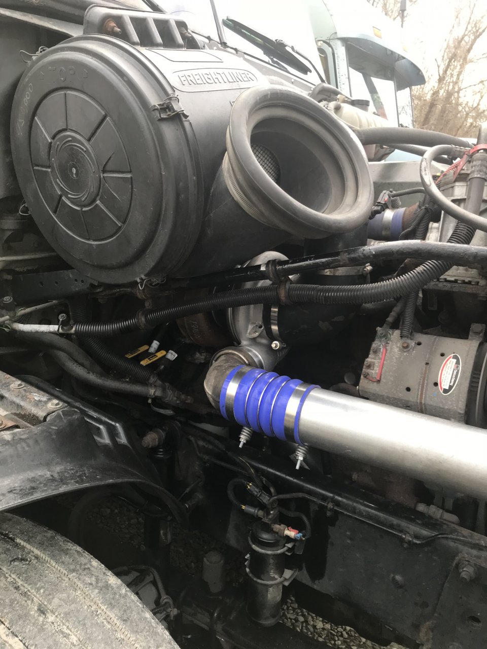

    I have an 07 Columbia that I just did this to....
    A Borg Warner turbo and the ceramic manifold and changed all of that piping out.....

    Yes he went by brad, how u liking ur new setup?
