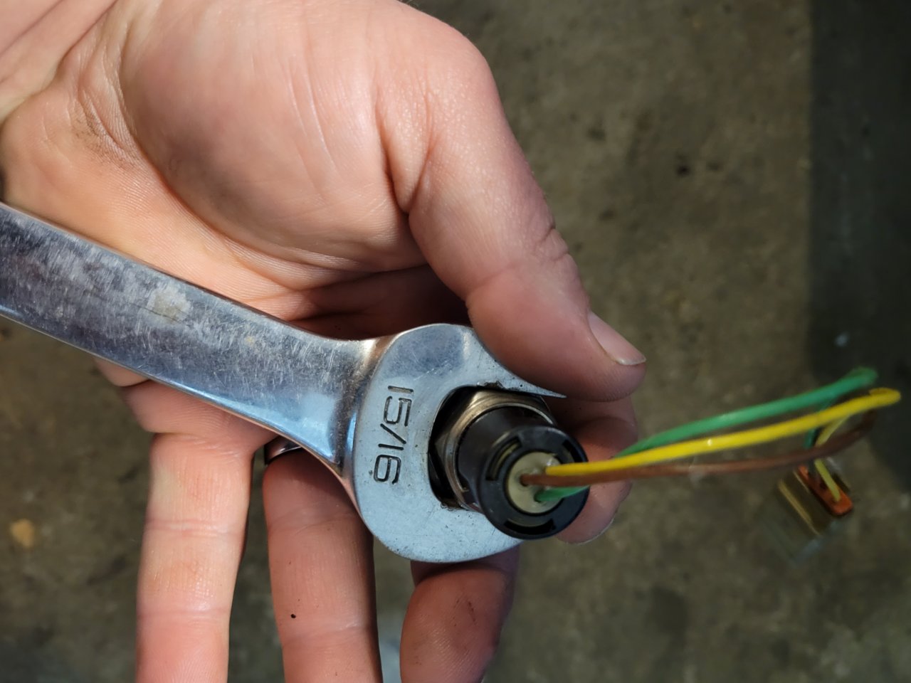

    Is this a egr engine? This is a ICP sensor from a 2005 dt466. Its under the valve cover, screwed into the oil rail.
    cprems Thanks this.

    Yes it’s a 15/16. I have an old wrench I cut down so it fits better.
    cprems Thanks this.
