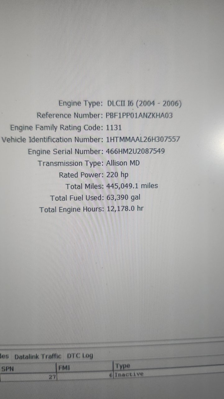

    I have a 2006 international 4300 with a dt466. Also Allison 2000 series. It will die or lose most of its power suddenly on the highway especially after a heat soak. If you clear the codes it has good power for a while then dies. When you restart it it has low power again.
    I have a hand full of codes
    421-426 injectors 1-6 low to high open
    454 cylinder 4 injector shorted to ground or b+
    332 ICP above spec engine off
    125 ICP signal out of range high
    113 electrical system voltage B+ out of range low
    312 EOT out of range high
    135 idle validation switch circuit fault
    525 injector driver circuit fault "M"
    It also seems to have a erratic ICP pressure when running badly/lopes.
    Top of the range is like 6000 psi. Is it even supposed to got that high?!?
    This is from servicemaxx all codes were inactive even right after it happened.
    Do all of those sensors feed into the idm? Am I looking for an idm issue? Just looking for insights and hopefully a place 20241203_202847.jpg to start from.
    Also according to fuel pressure sensor it has good fuel pressure. ~60 psi

    That is quite a mixed bag of unrelated fault codes! Does the engine do a 3 second injector buzz test when you turn the key on?

    Zero psi. It seems something is freaking out the ecm/idm intermittently. Normally the icp is fairly normal.

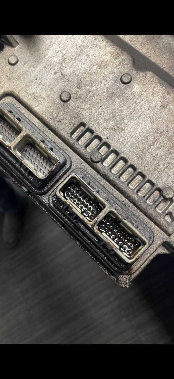

    I'm super sorry for the long wait. We are currently moving to across the country to Montana. I have been incredibly busy and haven't had time to do anything meaningful on this truck. However, I have now installed a IDM from a 6.0 powerstroke and had it reprogrammed. (Fun fact, it works.)

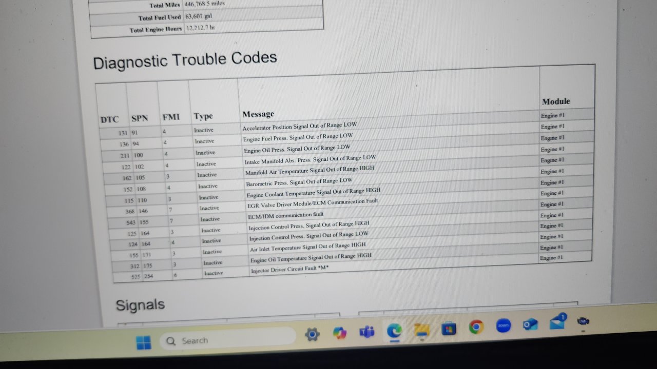

    It sure feels like it has more power. Runs better, a general improvement. I also installed a IPR valve. Genuine International. Set me back almost 600$ from the dealer. (Oof). Anyway as I was test driving it and also grabbing some sheetrock (Overkill I know) The CEL came on for a few seconds.
    Truck did not shut down as far as I can tell. If it did it was fast enough that it wasn't obvious. It has now set these codes.
  10. Benjafish
    Benjafish Bobtail Member
    8
    Nov 9, 2024

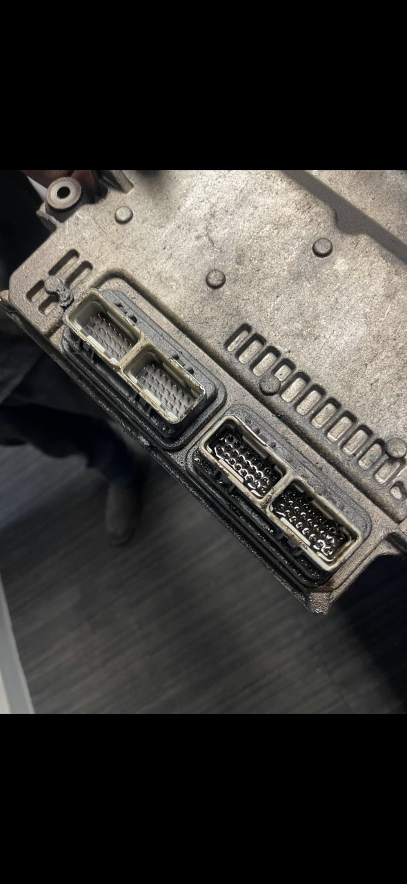

    As a side note, it also appears oil is pushing/wicking into the harness and into the PCM connectors.
    After studying the wiring diagrams graciously sent by Inderjit, I am wondering if I am losing my reference ground. (*Vref A and B). I am wondering how best to test this or, if I am going completely the wrong direction, where I should be looking.

    I strongly suspect a power and/or ground issue in the clean power supply. I am also wondering how the oil is getting into the harness. There are two sensors the oil pressure sensor and the ICP sensor that could be letting oil into the harness. Disconnect the oil pressure and ICP sensors and see if there is oil in the connector. The ICP is under the valve cover the connector is the second from the rear on the valve cover, page 326 in the manual.
