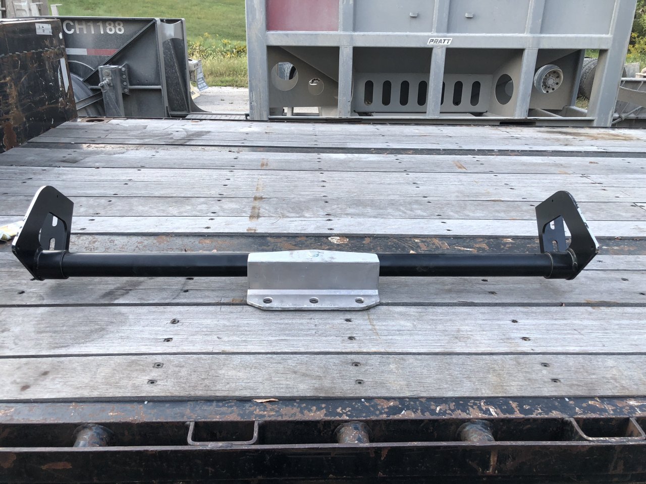

  8. David387
    David387 Bobtail Member
    13
    Aug 23, 2018
    This is the one I just picked up. All one piece.

  10. WrenchWrenchWrench
    WrenchWrenchWrench Light Load Member
    130
    116
    Jan 3, 2016
    We do these once a month or so where I work. They're not too bad. Remove the bumper and flip the hood forward and rest it on something that can support once you unbolt it. We use a pallet on a forklift with some cardboard between. Once its rested where it will sit still just remove the nut and bolt thats on both sides and have someone gently let it roll forward to where it wont move. replace the hinge and roll it back up. The hard parts is lining everything up while rolling the hood back up onto the hinge. We use two people to push up on the hood and one standing on the engine to catch it and let it down to where the studs are far enough through the mounting holes to get a nut on them. After that thread the bolt in on either side, leave everything loose and set the hood down and latch it in place.now your hoods aligned so reach in there and finish tightening them up with a 18mm. Open it back up, connect the wiring harnesses and the hinges and throw the bumper back on.
