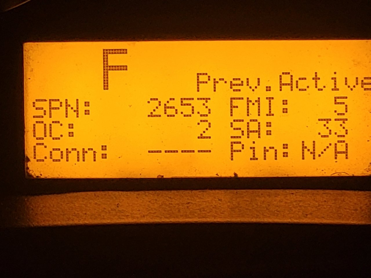

    I changed range sensor. Still only goes to 5th gear. Codes are below. Thanks.

    I changed range solenoid and still 5th gear only.

    the #2653 is the low beam driver side.
    The #560 is your problum "transmission driveline engaged"... not a clue what that means
