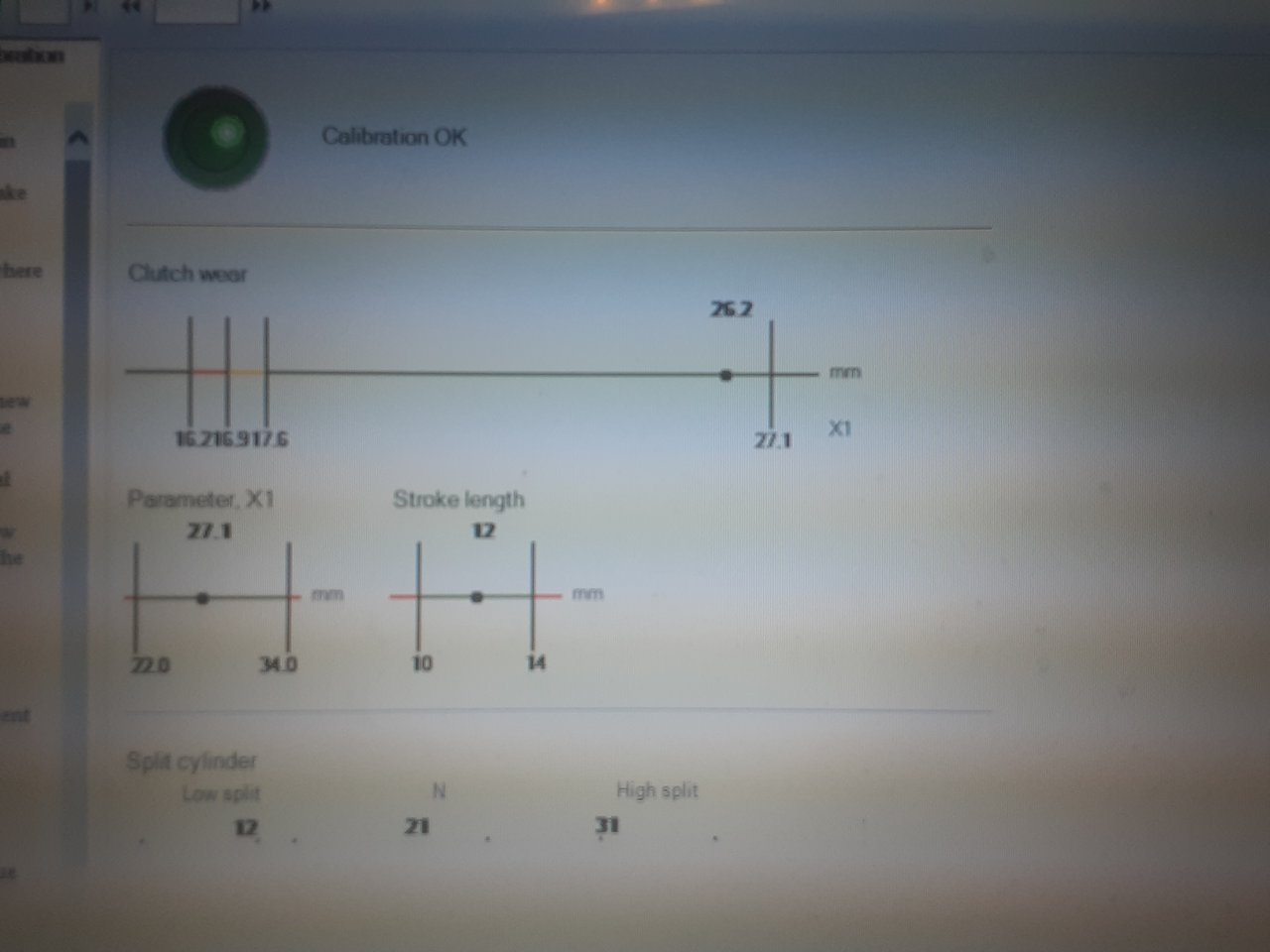

    Hello sir. Can you tell me if my clutch is good?? Attached pic
