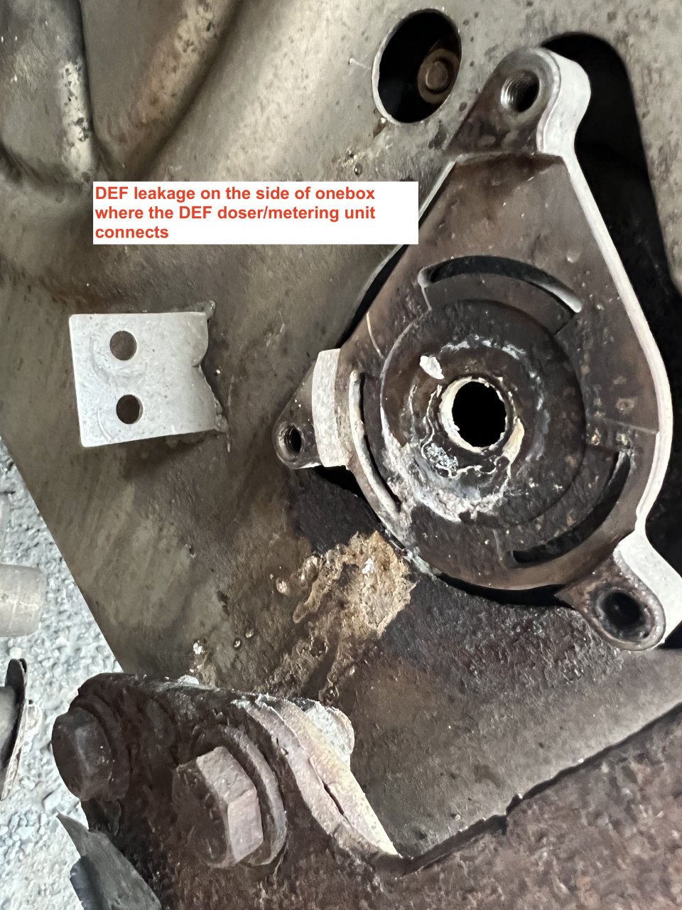

  7. Eaglewing
    Eaglewing Bobtail Member
    3
    Dec 7, 2022
    I changed the DPF filters myself, you can look at the DOCs in the images I'm attaching below. I ended up replacing the DEF Metering unit (AKA DEF doser, DEF injector) on the side of my Onebox as well, and replaced my DEF filter with a new one. The old one (pictures of old DEF filter attached) looked like absolute crap, which makes me believe the previous owner never serviced the DEF Filter.
    Attached you can see my old DEF metering unit/doser and the port on the one box with DEF leakage.
  8. Antinomian
    Antinomian Road Train Member
    1,921
    2,918
    Feb 17, 2013
    The DDDL software has a procedure for testing the flow rate of the DEF pump. If both the doser and the filter were clogged the pump might be weak now. Also, the line from the DEF pump to the doser is heated. Sometimes the heater coil fails. And as I said before, it could be a bad NOX sensor.
    Running a regen while monitoring with DDDL is the best way to find clues.
    Keep an eye out for soot marks by the vent slots on the one box housing. If you don't get the DPF filters sealed properly then you can have poor NOX conversion, which can cause the poor DEF quality code.
