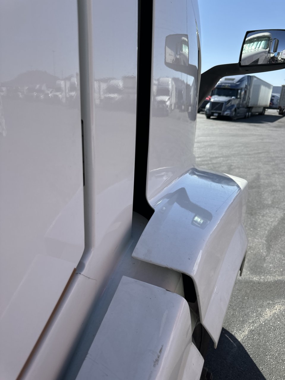

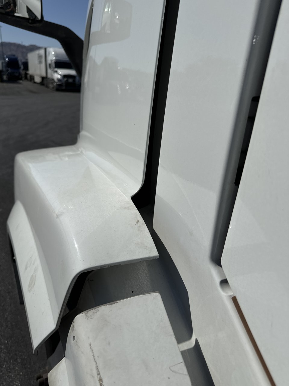

    image.jpg Hello,
    Please don’t hate. If you don’t like Volvo’s, please skip this post.
    Now, I’ve dreamed of owning a Volvo VNL since CDL school. That’s all I talked about in CDL school besides working for myself. Long story short, I finally purchased, not my dream model, but my very first Volvo VNL 670. She needs some work but I’m doing that as I progress along. Outside of after treatment issues, bunk windows leaking badly when it rains, and the hood bouncing like someone is jumping on it, she rides and drives smoothly.
    I’ve replaced all latches and had the hood cables adjusted. The latches have been adjusted up and down and I have taken her to Volvo dealerships, TA’s, love’s, and Pilot/Flying J’s. They all keep telling me that my hood is supposed to bounce like someone is jumping on it especially when I drive her. The also looks like she isn’t seated all the way down because the gaps are big enough you can stick your whole arm almost into the engine bay. Again, everywhere I go, they say that there’s nothing wrong with my hood. I even had the Volvo dealership mechanic go on a test ride with me. I made sure he saw what I am seeing. He told me there is nothing wrong with my hood and that Volvo’s hoods are supposed to be bouncing around like someone is jumping on it.
    I’ve spent well over $2,000 trying to fix this issue. Seriously, that’s how many times I’ve pulled into a shop just looking for someone to fix my hood issues.
    Are all these shops right? Are 2016 Volvo VNL hoods supposed to bounce and have gaps like mine? My Pictures may not provide perspective or maybe I’m just not yet used to Volvo’s just yet.

    I drove the same year, color and model Volvo. Was brand spanking new when it was assigned to me. Hood didn’t bounce around at all..even after I nailed a cow with it the new hood didn’t bounce either.
    Hard to tell from just one picture but it kind of looks like you have a new hood. Doesn’t look worn, scratched like that side panel. My initial guess is that the truck was in a accident and there’s something other than the hood causing it..

    The truck was in an accident back in 2017 when it was a UPS/T-Force unit. It was in operation with them unit 2019. The frame is not bent and I did have Volvo go over it as a pre-purchase inspection. But as I mentioned, I’ve been to several Volvo dealership and only one said the hood need’s new bushings. Just last week the truck was at the Volvo dealership and again I mentioned the hood and was told there are no bushings. But I didn’t push the issue because the bill was at $8,600 and I was fighting with the warranty company. I know for sure the hood isn’t supposed to be sitting like in the pictures. But they keep telling me it is.
    The side fairing is scratched because it keeps falling down because the pins need to be replaced and the safety cords are ripped apart. This truck has seen better days believe me. But I will get this truck back to its original design. It’s just going to cost a lot of money to get it there. The motor is strong and she runs like a charm. But cosmetically she need TLC.
