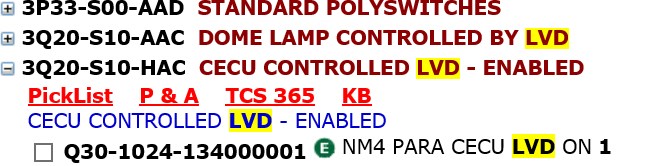

    Last 6 of s/n
    It can have a cecu controlled disconnect in which case you can turn it off with ESA.
    It could also have a hardwired one that you can manually bypass

    469663
  6. pushbroom
    pushbroom Road Train Member
    1,723
    7,011
    Sep 1, 2012
    It has a cecu controlled LVD. Need to swing by the dealer or someone with ESA and they can tun it off.

    No there is no other way. It is a parameter inside the CECU. Cecu is located in the hotel at the lower kick panel between the two seats.
