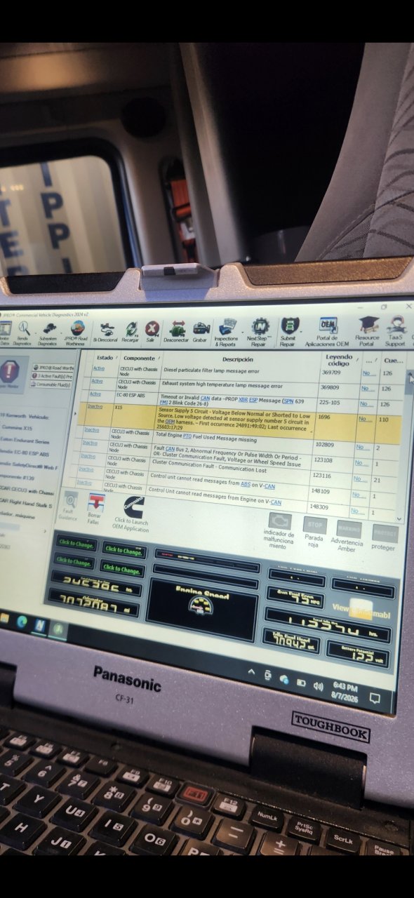

    Hi thank you for your answer. The problem came back today, here are the last codes, this is from a month ago. Thanks again!

    You have an intermittent short to ground somewhere in the 5volt supply wire to the throttle pedal sensor supply. You must also check the Kenworth drawings to see if the Throttle pedal 5volt supply is shared with any other devices. Most throttle pedal circuits are dedicated 3 wire twist- Purple- green and blue.
    Purple is your supply.
    Start by pulling kick panels from below steering column and inspect wiring for all contact point from pedal sensor to firewall. Lots of brackets and braces to rub on. The rub will likely be just thru the insulation or barely touching to ground.
    Westrada1982ok Thanks this.
