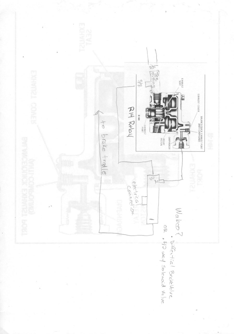

    I have done some tracing on the service line to figure out where it is routed. From the relay valve it goes to another valve mounted further back under the cab. I'll call this the mystery valve as it is very hard to see and buried by cable looms of wiring, air lines, etc. The mystery valve seems to be straight through. I don't feel any 3rd air ports, though, there might be an electrical connector (this is all based off my memory and I could be wrong). From the mystery valve it goes back to the treadle valve on the firewall. All the lines are 3/8 so that seems to be a signal line.
    So I think this valve is used for front brakes because of the color of the lines and location. Can anyone confirm? This WABCO general troubleshooting document seems to be the closest/most accurate for my truck.

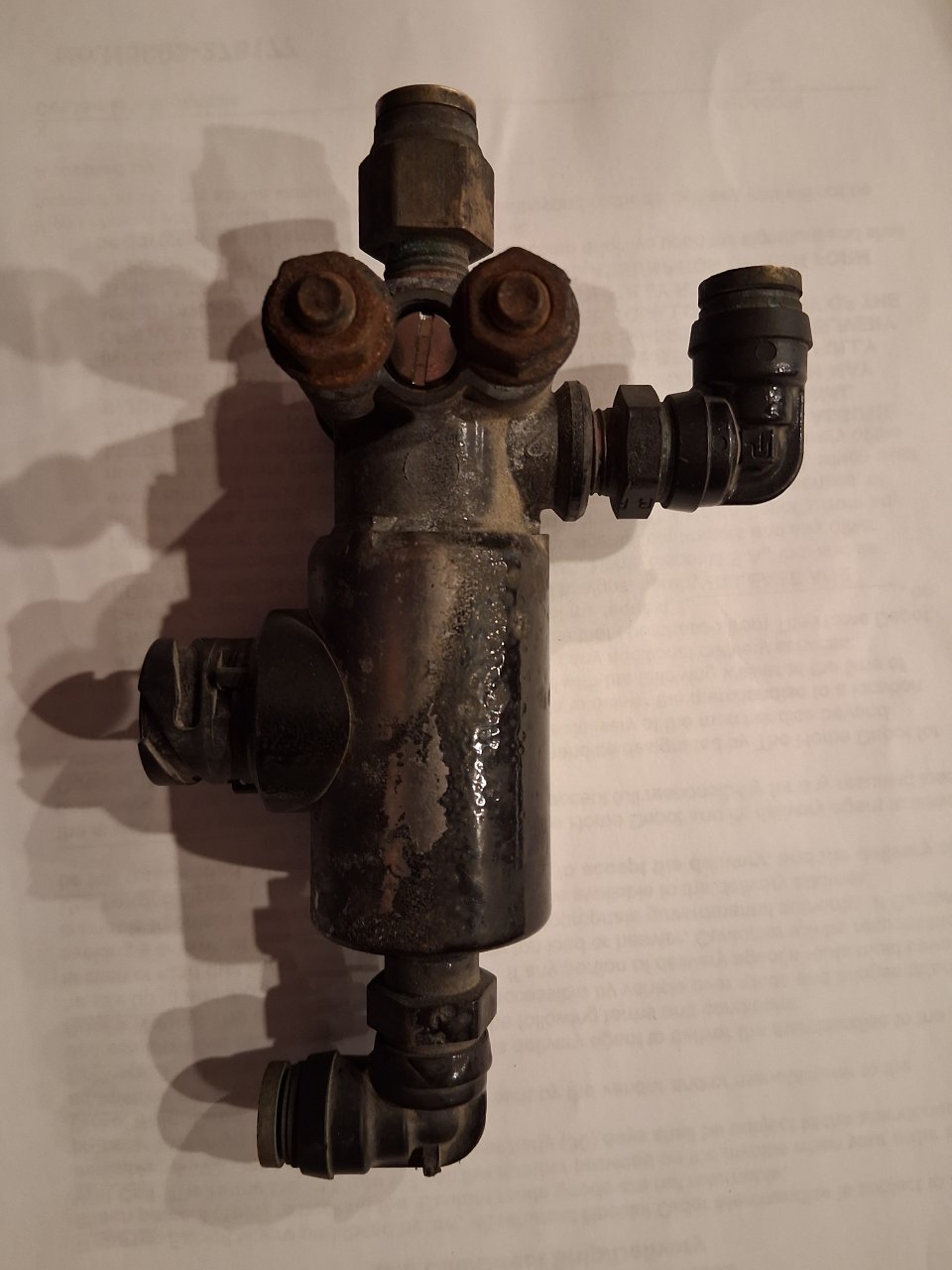

    I did some more digging. There are 3 lines connected to the mystery valve not 2 as I originally stated. The valve is either a Wabco differential brake valve or a Wabco 3/2 way solenoid valve. (Page 29 & 30 of the PDF ) The markings on the paint are in terrible shape so it's really hard to get the numbers. I also got a much better idea of the line routing so now the picture is becoming more clear to me. See my updated plumbing drawing (Int'l partial brake ckt). I can blow into port 1 on the Wabco valve and air comes out port 2 sending it to the balance exhaust port on the R-14 relay valve. I presume that air should be sent to port 3 in normal operation and port 2 as required according to pulses sent on the electrical connection to control the valve.

    @Heavyd that drawing is incredibly helpful. Thanks for sending! I am glad to see it matches my crude hand drawing. Part #2 Traction solenoid valve would seem to be the logical culprit based on my symptoms. I did a check with my meter and the solenoid measures about 8 ohms. I suppose I could also check for voltage on the connection but maybe that voltage is only present when needed?
    Anyhow, it seems logical that the valve has failed. I don't think it should always dump air to the R14 balance exhaust port. Would you agree?

    I removed the supply air at #2 C and no longer hear the leak at #15. Like I said in my previous post, if I blow through the valve at C, air flows from C to D. I tested this by pressing the brakes and I can feel air at D every time I press.

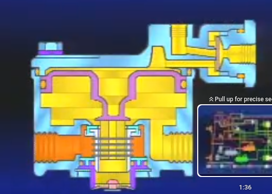

    OK, I see why I was confused and going the wrong way with my logic. My understanding changed based on two different drawings for the R14 valve.

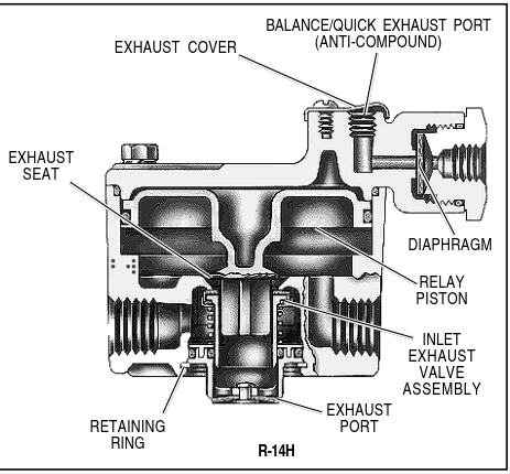

    The R14 w Passage Way drawing clearly shows that that service port air acts on the piston and moves it down. This in turn opens the valve and supplies air to the delivery ports. The delivery ports supply air to the brake chambers and cause them to move.
    The drawing that had me confused was R14 no Passage Way Shown. I was interpreting the drawing literally as shown and thinking air was getting routed out the exhaust because it had nowhere else to go. I should have read more carefully. The dialogue explains the operation of the valve even though the picture doesn't depict the flow as well as the other.

    Your commentary lines up very closely with my understanding plus the new things I just figured out about R14. The only area we differ is on the cover for the R14. My understanding is that the valve has an exhaust port on top. I have not heard of them leaking through the material but I suppose anything is possible. I just haven't experienced that before. Plus, there can be minor differences depending on who made the part and how it is used in circuit.
    I did take out the R14 valve at one point and performed a general inspection. I didn't find any obviously broken plastic on the piston or bad o rings. That's what caused me to suggest that there could be some internal leakage. Maybe the O rings look ok but not good enough to allow air to be delivered to the chambers or the piston is sticking. JB7 had a good suggestion to watch what happens when applying the brakes. Anyway, we both agree that R14 should be replaced. I'll report back when I get R14 changed out.
