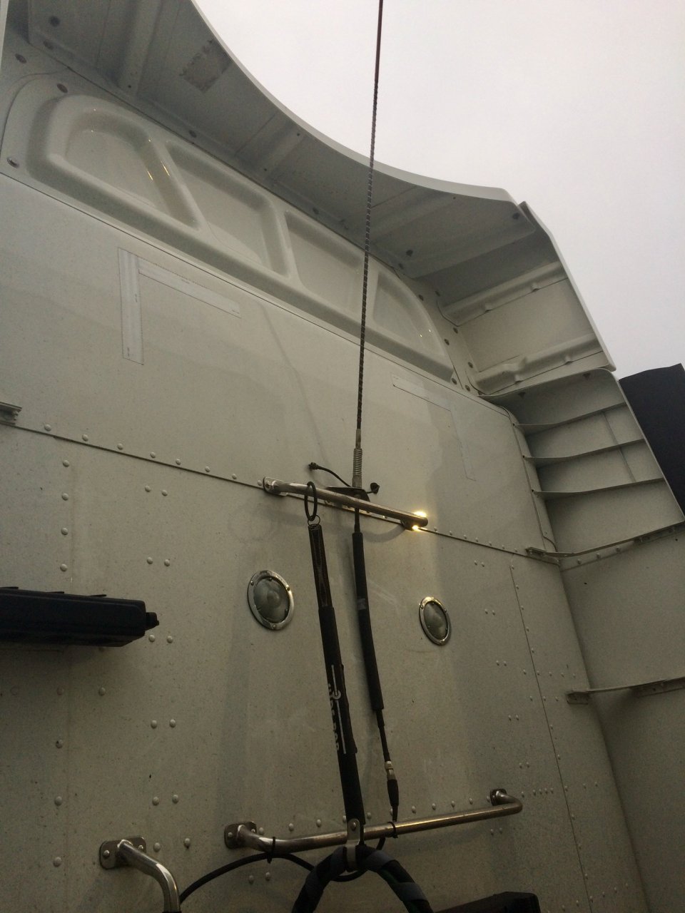

    Where is the antenna mounted?
    Back of cab? Then it requires a top load antenna.
    If so, you want:
    1). 5’ Skipshooter
    2). SS spring
    3). TOP GUN TEC Mount stud
    This will get above a van by 4” plus. I’ve had no problem with it 90k miles.

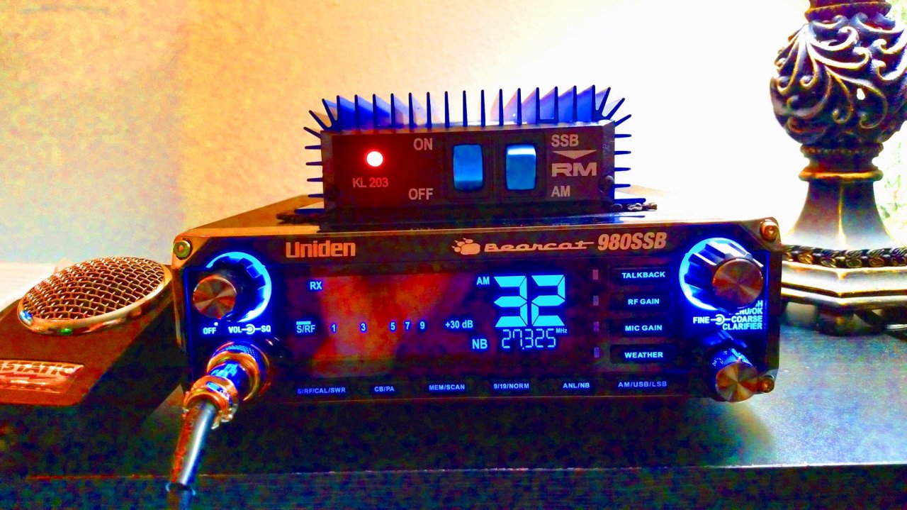

    You should also add:
    4). RM ITALY KL203 amp that will run with the radio off the 15A factory binding posts.
    75W for $75 off eBay

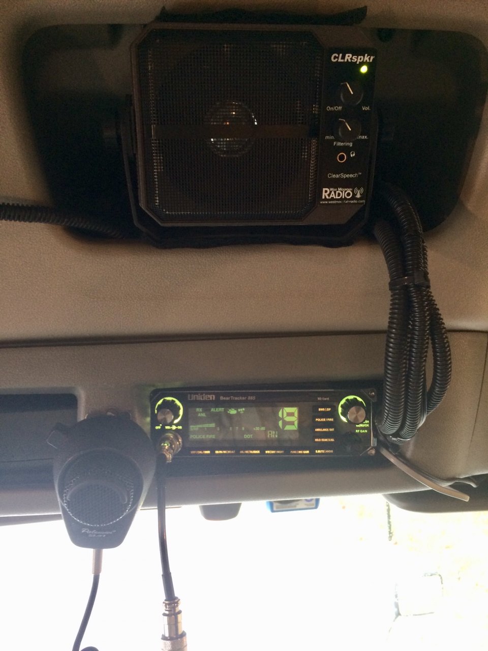

    The final piece of gear is:
    5). WEST MOUNTAIN RADIO CLEARSPEAKER
    has variable digital signal filtration (as used on high dollar Amateur radios) to clarify weak signals. Perfect for SSB also. $199 (this is a life-changer it’s so good).
    This setup will outperform every $500 Big Radio out there with the 980 you have.
    I ran RG8X Coax thru an existing hole in sleeper and draped it high up to the factory cubby hole.
    I’m currently running a UNIDEN 885 Hybrid CB/Scanner as shown.
    Set SWR with separate meter, plug in the rest and go. No need for tech to mess with anything unless he has — and can use — an antenna analyzer.

    Then stick it in a closet. Because a center-load won’t work worth beans there, unless
    1). You are ALWAYS bobtail; and,
    2). The other party to a conversation is ALWAYS behind you.
    The 5’ Skipshooter is $25.
