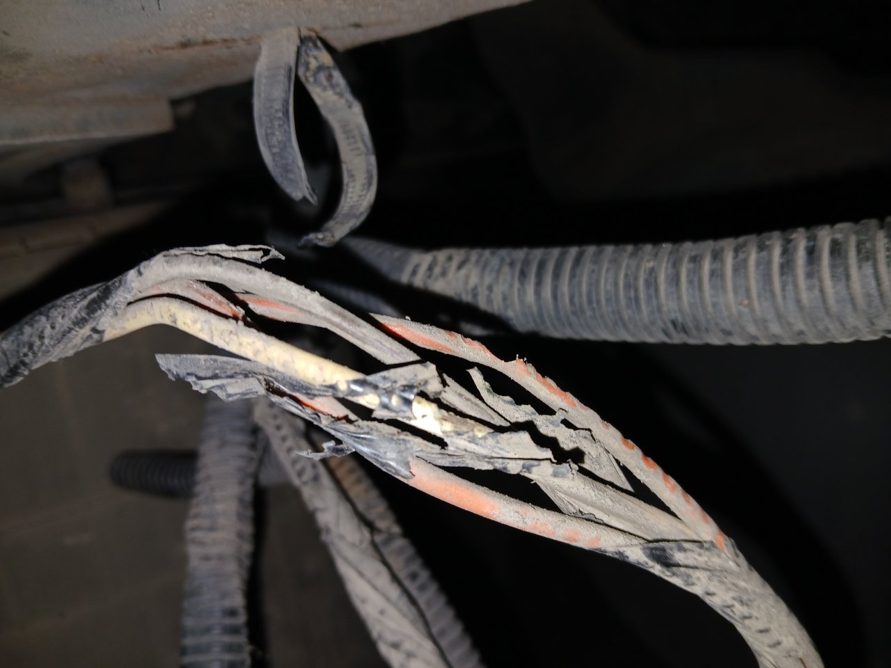

    2021 International LT625. The light illuminates when switched to running, but the left tail light signal is not functioning. No fuses are blown in the box under the passenger side dash, and the wires show no signs of damage or wear. Should I just get a new one?

    My lonestar has the same tail lights as an LT. When mine did the same thing it was a rubbed wire. i would check the wire is live with a tester and if not check further up. Mine was rubbed through at a ziptie and so caked with dirt that i had to cut the ties and rub the dirt off to find it. Snip the wire and use a shrinky dink on it and it should be fine after.

    As a quick test, you can plug the left side wiring into the right side light to see if you have a light or wiring problem.
    There are no fuses for those. That is a body computer powered circuit. If the computer senses a short it will kill the circuit until you cycle the key.

    Thanks! I found it at the first zip tie spot. I really have no common sense about these things! You rock! Thank you!
