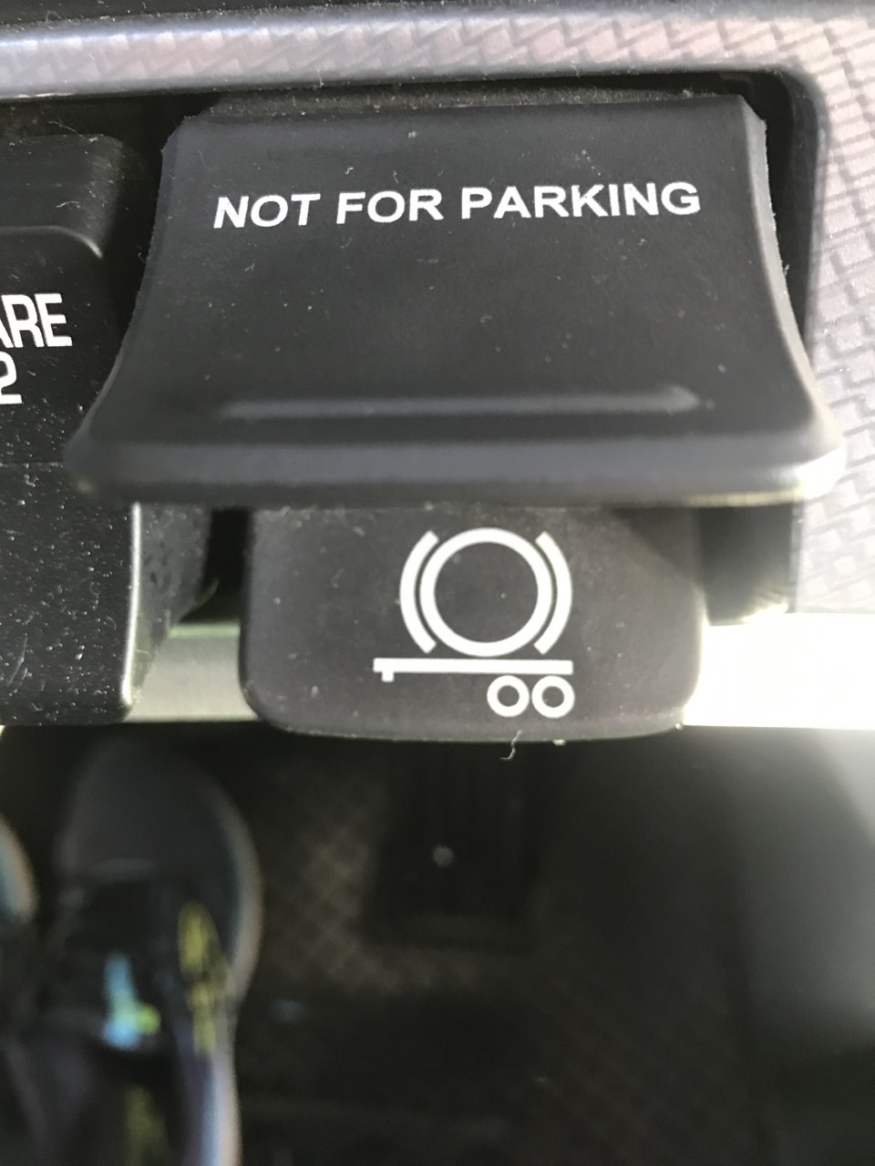

    Do you have the little paddle thing, down by your right knee? PACCAR started offering that as a trailer brake. If you don’t have that, the truck doesn’t have one.

    My buddy cut a 2”X2” board, making a prop he wedges between his brake pedal and seat, to check brakes.
    I have the paddle thing and bought a spring-loaded clamp to hold it pinched, when I pre-trip. I’m leaving out in a few hours and will grab a pic and post it up.

    This is that paddle for a trailer brake.
