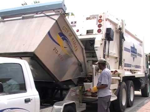

    The new EZ Pack Goliath 400 rear loader 31 yard I think has a compaction ratio of 1200lbs per yard so that's a 37,200lbs payload so I would say yes a 31 yard truck will be fine.

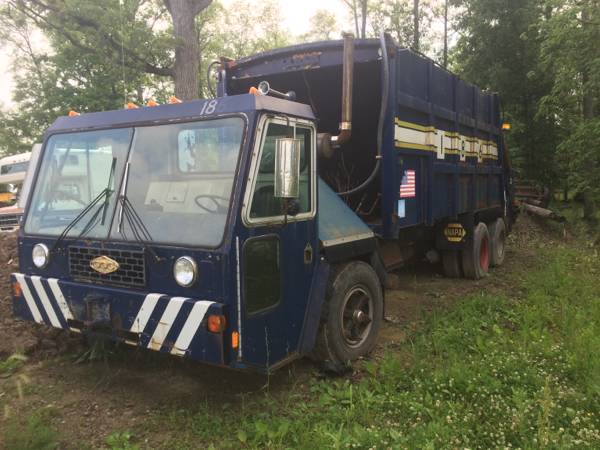

    They were a big buyer of Crane Carrie Cabs and Chassis this is a 1989 ex-city of Lakewood, Ohio garbage truck with a Leach Packer body probably a 25 yard body.
