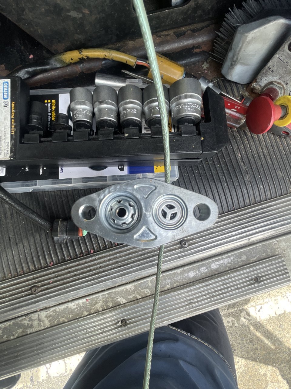

    When pumping the hand pump does it feel like it’s doing anything?
    pull it off and post a pic of bottom of it so we can see the check valves. Possibly one flipped but doubtful since this started after you put lines on it

    The primer does absolutely nothing it’ll work once I pull the line off the ecm and put it into a jug of fuel but it doesn’t hold and sends the fuel back into the jug once u lock it in place. Primer also a day old as well

    Check valves are right so take the ECM lines and hook them together to take it out of the equation. Fuel doesn’t have to go through there were hunting the restriction through process of elimination
