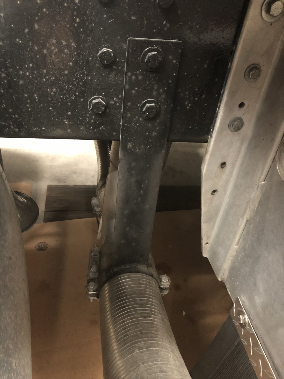

    You can also build your own out of steel, stainless steel bolts, and thick cord impregnated mudflap rubber.

    My old lady isn’t air ride cab so they don’t need to be flexable. The flex pipe is good enough. These home made ones were built for it years ago. They are 3” wide 1/8” thick. They support everything just fine. The originals were aluminum and cracked beyond repair decades ago.
    Mr. Cob Thanks this.

    On my truck there is an 18" long section of stainless steel flex-pipe in-between the Y pipe and the elbow that goes up to the stacks. I thought about just using solid hangers much like what is in your photo to support the Y pipe, but if the Y pipe were solid mounted that would put a sever strain on the flex-pipe between the Y pipe and the stacks because of the air mounted cab, I am sure it wouldn't take long for the stress to break the flex-pipe coupling. So I will just repair everything and put it back stock, the amount of miles "I" am going to be putting on this truck ( about 15-20K per year ) I could probably get by not replacing these mounts and just let everything hang from the stacks but I don't roll that way.
    Dave
