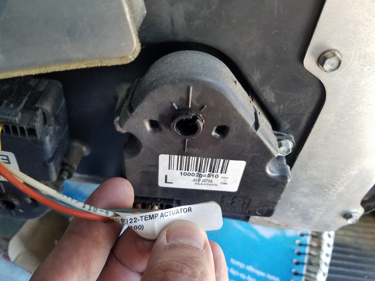

    I'm wondering if the temp actuator is causing my temp issues ?
    Hate to just throw parts at it and hope for the best especially at Peterbilt prices. 20190416_124026.jpg

    If you cycle cold to hot. Actuator should go from mark to mark. Pull it off and make sure the door moves. Dont try to force it with the blower on. The air flow will hold it closed with the actuator off.
