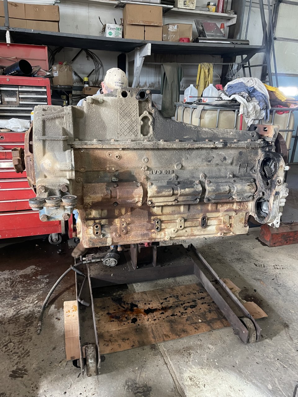

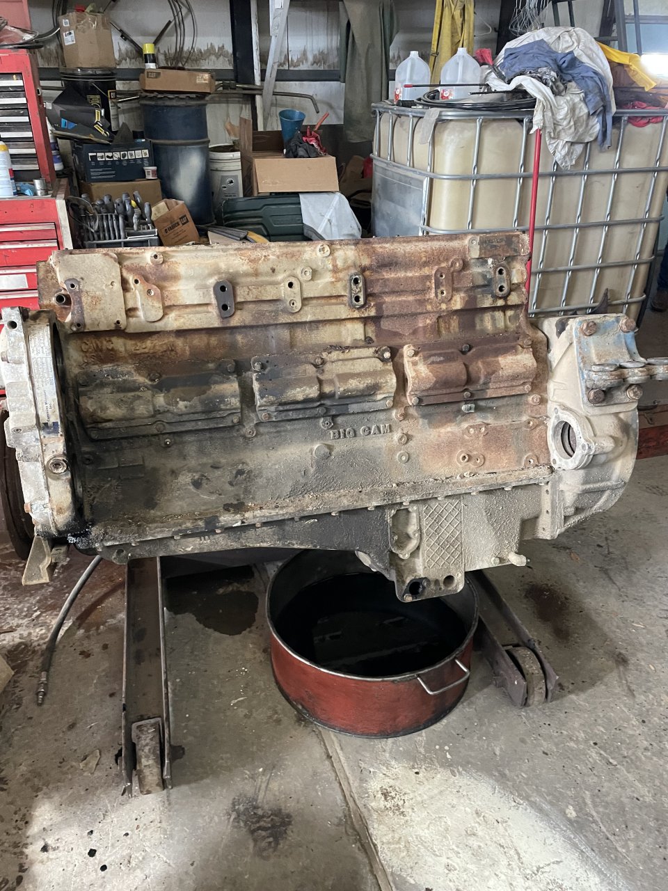

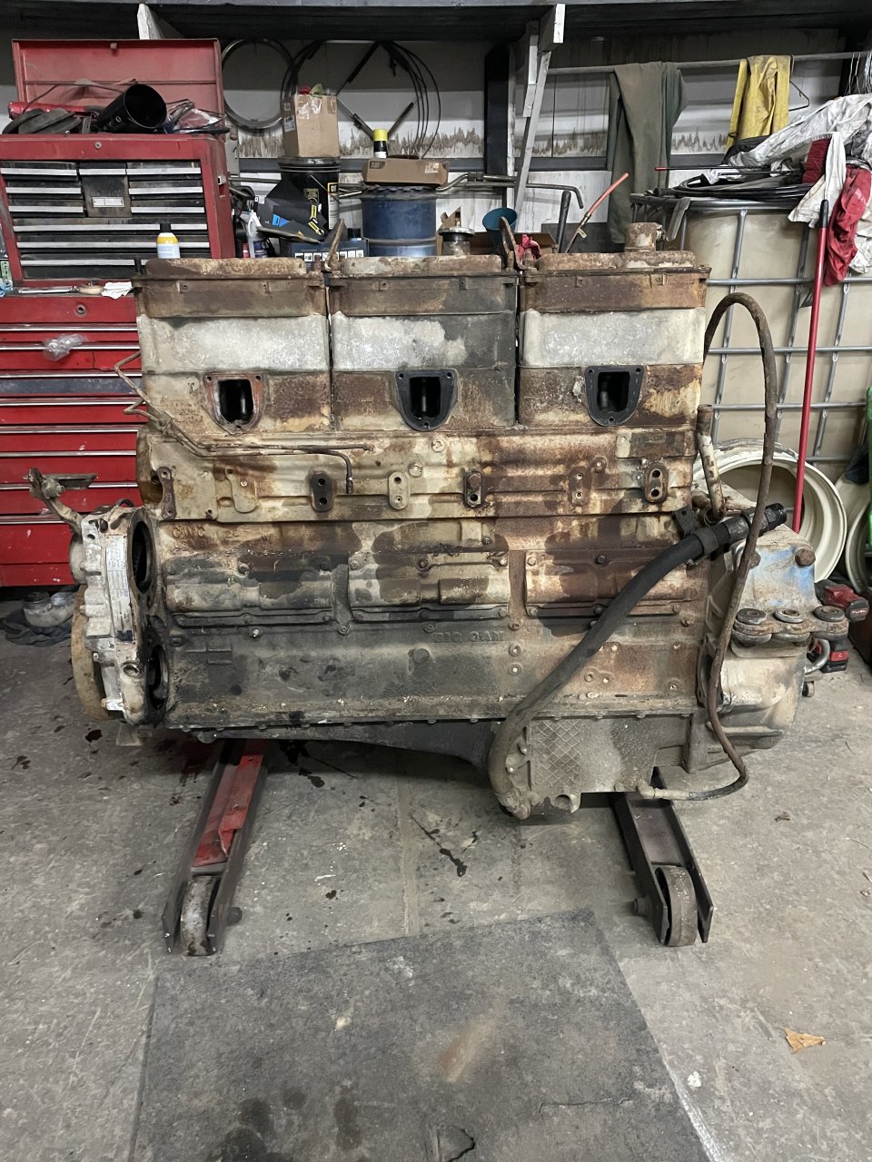

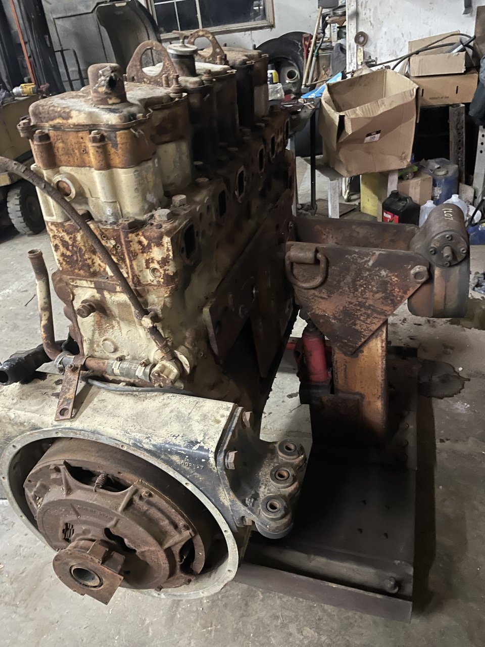

    CPL 393, is a BC1, 400. So, my FIL found this engine(core), in an ‘80 352 Pete. It has been ran in decades. He want it built back to original CPL. Tear down process is nearly complete and I must say, the engine stand I bought is turning out to be a blessing. Everything on the bottom end looks great and the deck is in good condition, as well. Only thing I noticed was a broke compression ring, in number 1. There was absolutely no water/coolant in the pan. However, the upper bores, coolant jacket that runs to each head has a ton of rust. All the mains and Rod bearing looked ok. Liner o rings were deteriorated horribly and that’s to be expected. I’ve got the oil pump, accessory drive, oil cooler, water pump, cam followers and front cover, all off. Only thing in it still, is the cam and crank. What’s the best way to clean all this #### out of the water galleys and upper bores? I put ear plugs in the crank/rod oiler holes, to keep trash out. IMG_7476.jpeg IMG_7482.jpeg IMG_7481.jpeg IMG_7487.jpeg IMG_7490.jpeg IMG_7509.jpeg

    Having a hard time running down an in frame kit for CPL 0393, engine serial #10832855. Interstate McBee is “Out of stock” and some of the other aftermarket manufacturers don’t even offer a BC kit. Cummins price is $2,650 and they’re checking availability. Other manufacturers are PAI, IPD, Heavy & Highway and AgriKits. I’m not to sure on those last two’s quality control. Any ideas are appreciated.

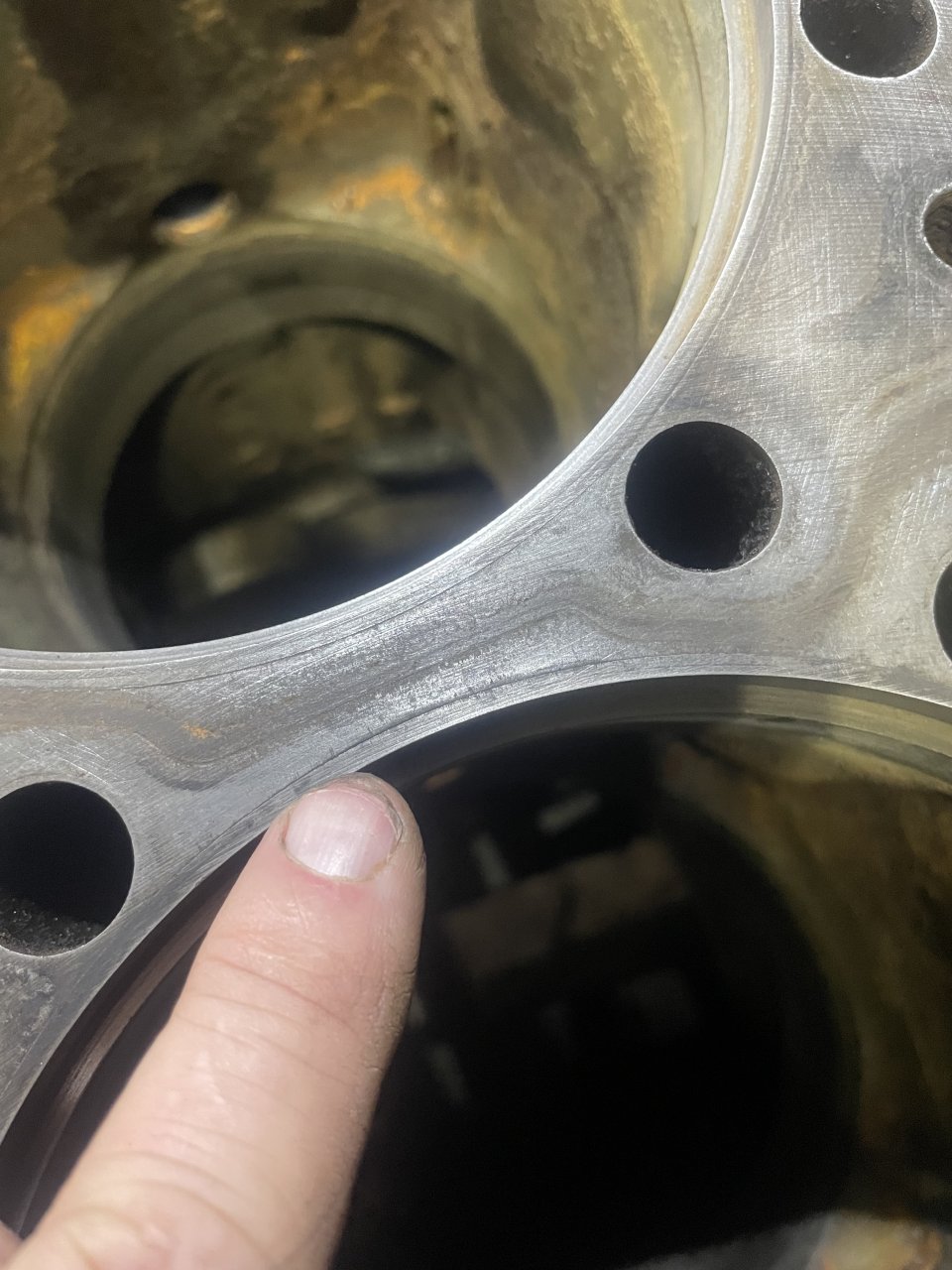

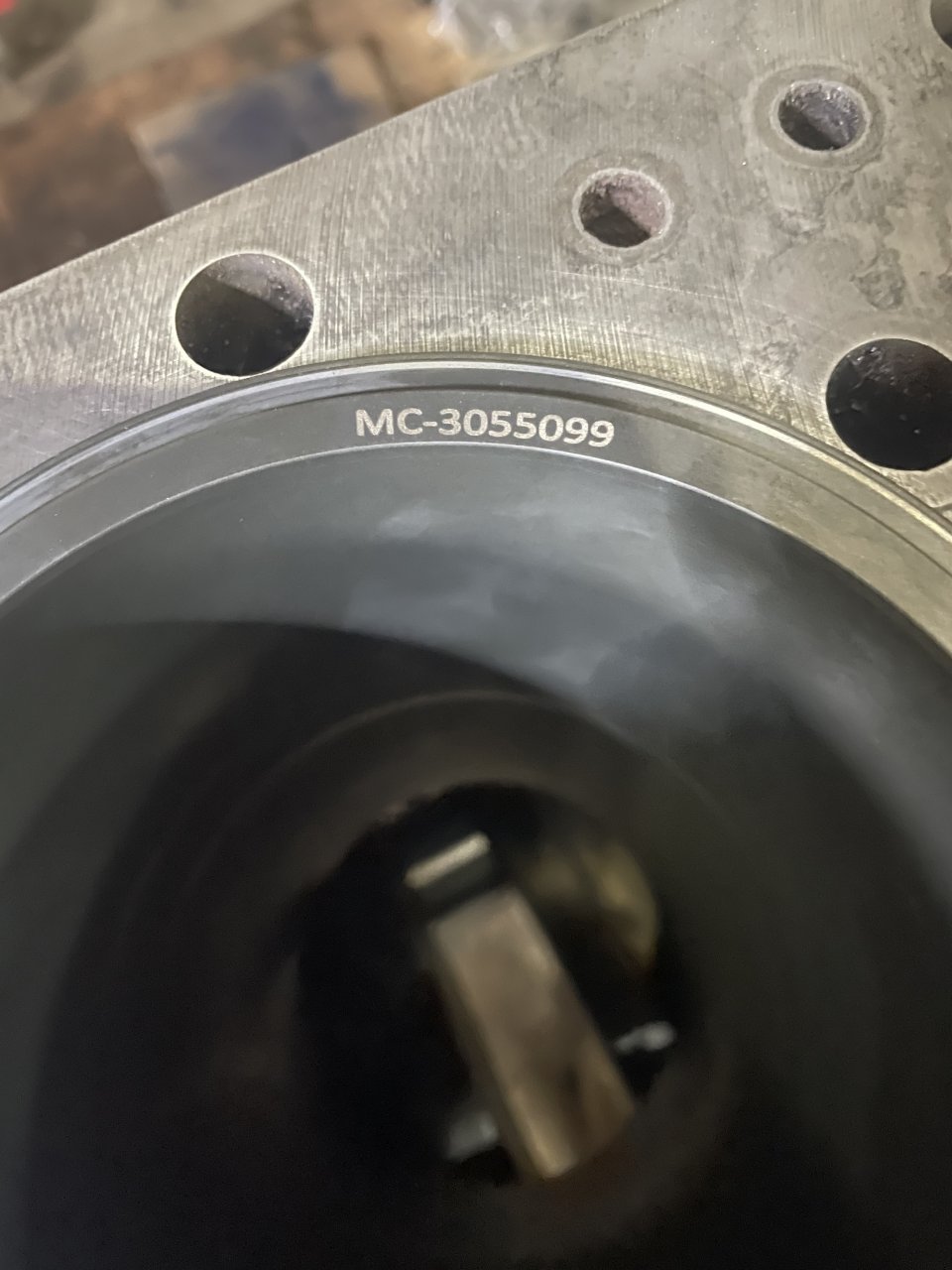

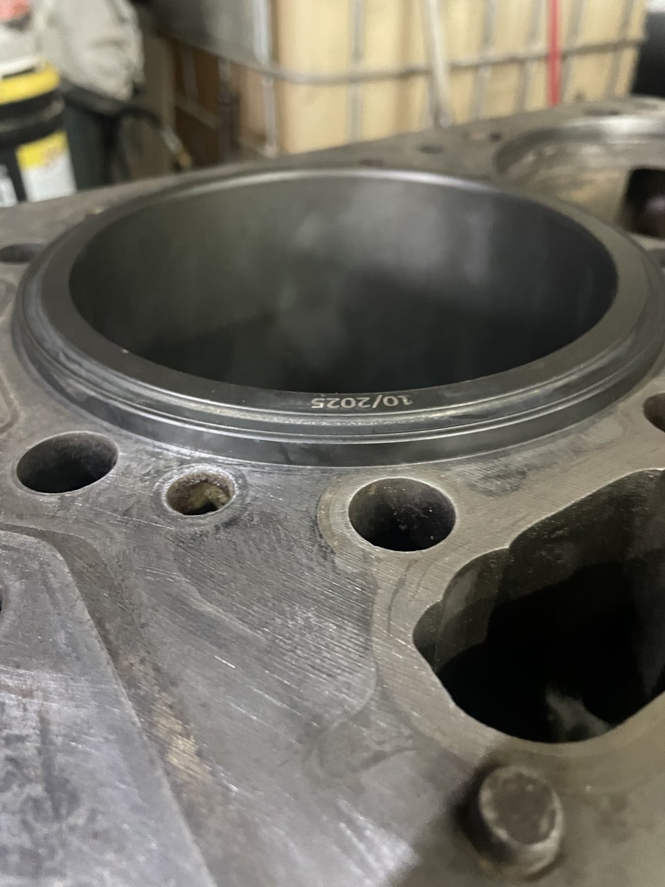

    I got an Interstate McBee kit in. I noticed that this engine has liner repair sleeves. Now, when I order the kit, the guy asked me for piston and liner part numbers and I gave him those from the existing. I tried dropping a new liner in to check protrusion but it won’t go in, in any of the bores. I cleaned an old liner up and it won’t go in. It would if I pressed it but I don’t want to do that. What do I need to do? IMG_7606.jpeg IMG_7603.jpeg IMG_7604.jpeg

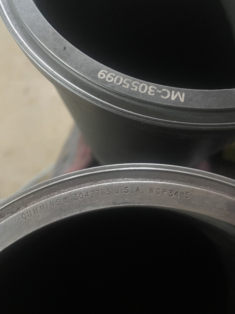

    Here’s a pic of the part number on the old liners, beside a new liner. IMG_7612.jpeg
