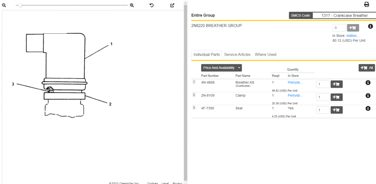

    Looking for a part number for a pcv valve, from peterbilt.

    Are you just needing the filtered breather attachment?
    PCV valves are for gas engines

    Yes sir.

    This what you are looking for?
