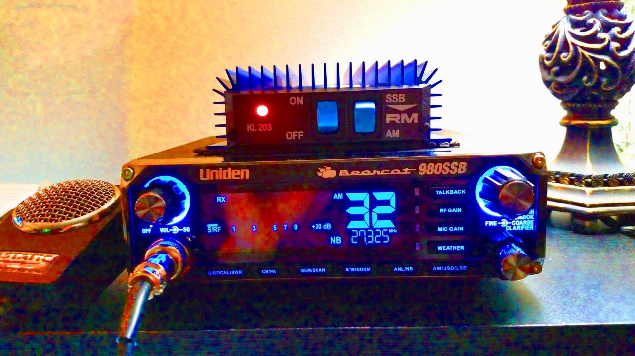

    The holy grail is the ASTATIC 575M6. No longer in production. Read at Bobs CB for description. EBay about $200 NIB.
    Get that RM ITALY KL203 baby amp on there.
