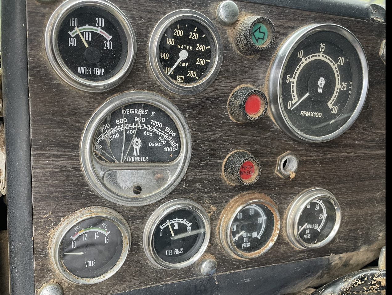

    Hey fellas does anybody know what size the smaller gauges are in the k100?Im looking to add pyro and boost gauges in my dash and don't want them to be bigger than the stock ones thanks

    Pyro is not as small as the oil pressure, amp gauges in my 83 K100C….
    B1364672-B4D9-4AD6-81B4-12C85DF15962.jpeg 17FAB5D0-4B9D-41A4-98E2-FB540AC1F013.png

    Pretty sure 2",, 2 1/16" hole, was the standard for most small gauges. I have seen small pyrometers, but they are hard to read. Those KW pyrometers were used for years and should be no trouble finding a NOS one.

    The smaller gauges are 2" holes but most of those gauges have a Indexing mark on them so you might have to file a slot in your hole for the mark
    As @OLDSKOOLERnWV stated most of the pyro gauges are 3" holes which is the size of the bigger gauge your refering to

    Isspro does make 2” pyros that have same faces as the 3”ones. They offer choice of both black bezel or chrome. But because they are not as common they are around $100 more than the standard 3”.
