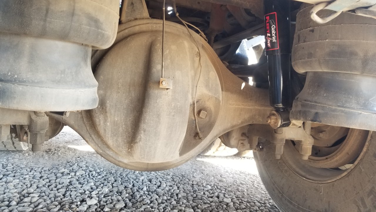

    I have air leaf on a 94 peterbilt 379

    If i air the bags up to where it is like you said, then when it's done the back air bags are way over extended and front will be set right

    Why does it only seem to be putting pressure on the front axle and then when deflated only sets on front axle stops?

    The rear bags do have air in them when they're supposed to, right? I mean, the front exhausts completely and the rear stays high, but when the front is filled back up, the rear fills too. Right?

    Yes back airs up before the front. All four gets hard when aired up.. Back airbags feed front airbags.

    Pictures was loaded, but does same both ways loaded or empty.
