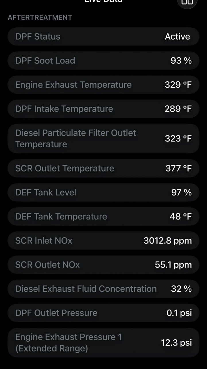

    I’ve been noticing white blueish smoke coming from my exhaust during my driving. It usually lasts about 5-7sec. It started to happen about 3-4months ago and recently had a check engine light come on ( spn:5319 fmi:31 ) I had the 7th injector cleaned after that code came up an the issue went away until now. Is the 7th injector overspraying and causing this to happen? I was thinking of installing a new injector and hope it solves the issue. What would be the likely cause of this issue?

    I believe you will tend to get white smoke when the DOC is starting to break down. If the DOC has never been replaced then it's a possiblity with the mileage you've put on it.

  4. Heavyd
    Heavyd Road Train Member
    7,824
    6,273
    Feb 4, 2009
