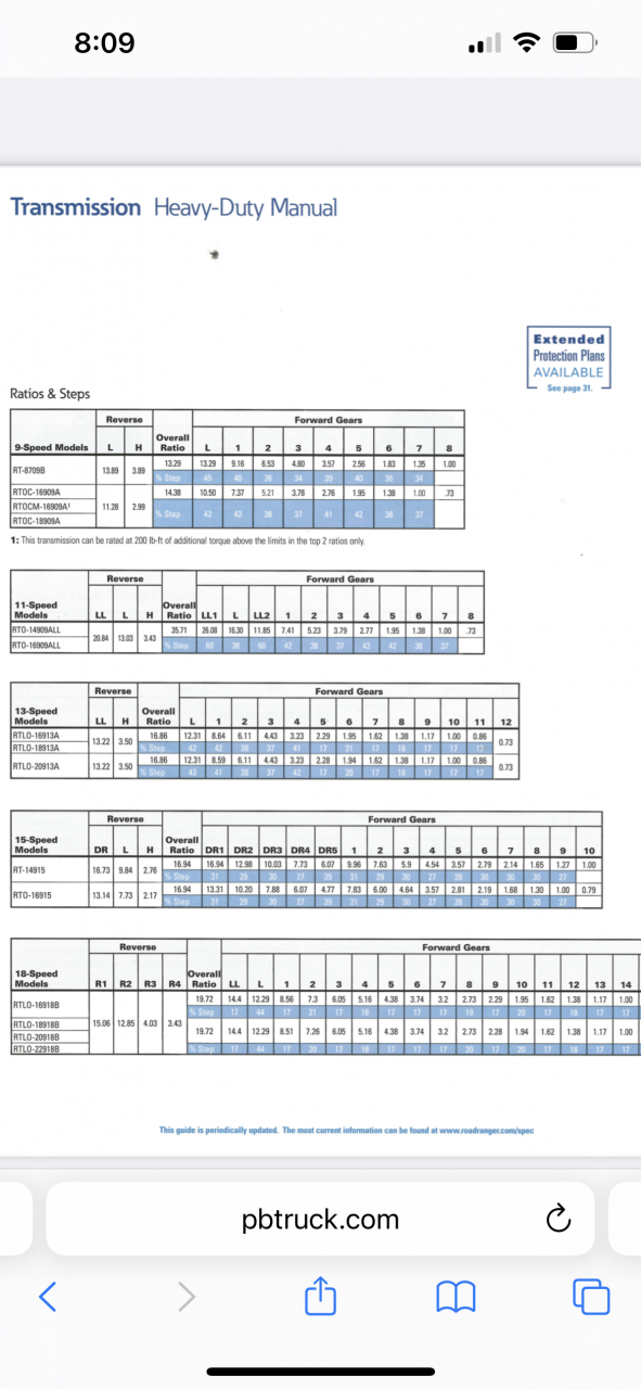

    IMG_0015.png Why would the 15 direct not work for you for what you do?
    Higher rears need less over drive at road speed and more reduction to get rolling. A 15 direct is lower geared all the way around than a 15 over so again why wouldn’t it work.
    2.64 rears a 1.1 trans and 24 talls is 81mph at 1800 RPM. Exactly how fast you want an old binder to run? The problem you’re gonna have is lifting in soft dirt and the side load from that big ### pinion. Above is a ratio chart for a 15. Higher the number the lower the gear or more reduction. A 15 direct has more reduction than any other trans beside a 2 stick. You’re gonna need that on a gutless big cam.

    Is deep reduction gonna be lower with the RT and 2.64’s, than DR in a RTO and 3.73’s or 3.55’s?
  8. wore out
    wore out Numbered Classic
    17,256
    213,738
    Jun 5, 2013
    CHASIN THE DEVIL'S HERD
    I can figure it but rather not I can tell you from experience it’s really close. But you are correct that it’s better to go lower out back not running the boulevard. Reason I say that is the higher your rears the more teeth is on the pinion. The more teeth the pinion has the farther away from center the ring gear has to sit on the carrier. This causes a side load effect from simple leverage. Now with 90k in the hopper and 16.94 reduction something is gonna move. Be it the load intended, the drive line twisting or the differential carrier ####ting it’s self out the back of the housing. If you were staying on hard surface I’d say you’re probably ok with the high rears and direct. However I will say if you decide to go high rears and an RTO you’ll hate that m’fer
