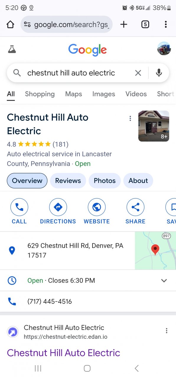

    Call these people, they are awesome and specialize in alternators

    No i just put on the 210 amp. Thwy are very knowledgeable, and are super nice people. They will be happy to answer any questions that you have.
