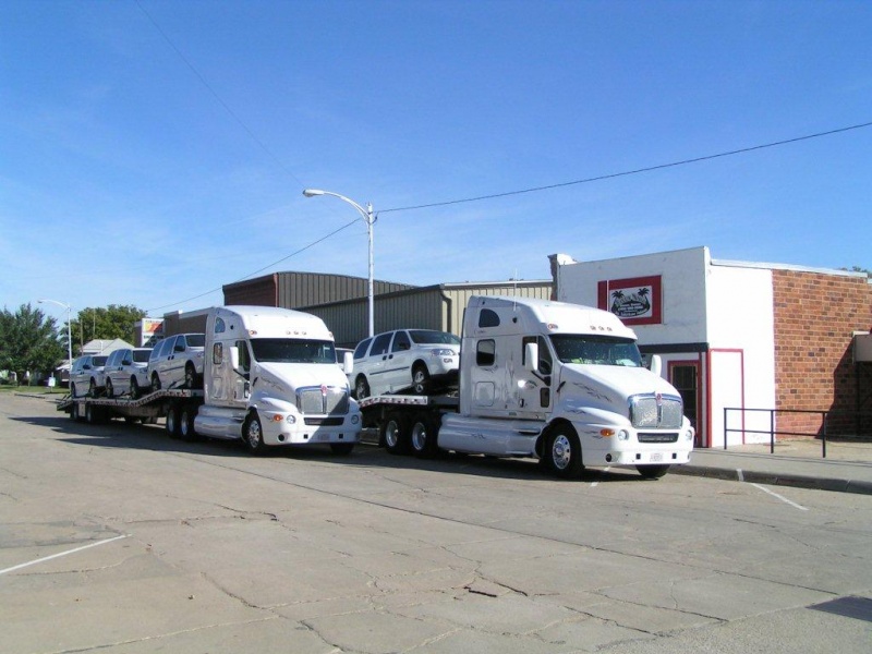

    All depends on WHAT aluminum trailer you have, a GOOD aluminum trailer won't have welds, it will be riveted or bolted together. Over the years I have had Chapperal build me over a dozen ALL aluminum trailers.
    Right now I am still running 6 2005 custom build Chapperals, NEVER a problem and we average OVER 150,000 per year, per truck.
    Problem is that Chapperal sold out 5 years ago, and they were NOT CHEAP to buy!
